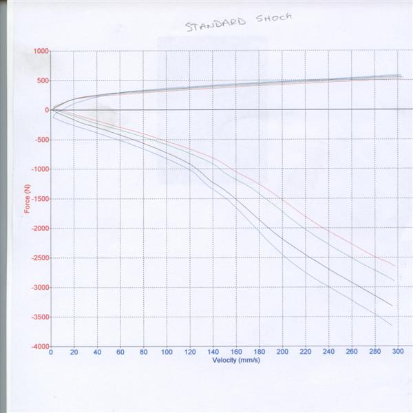

I dyno'ed the rear shocks off my '91 zxr750 J1 at work. Thought they may have been of interest to others.
The standard shock has four settings that adjust rebound only (as you can see):
standard shock
standard shock
standard shock (Medium).JPG (35.39 KiB) Viewed 2064 times

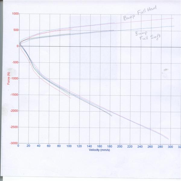

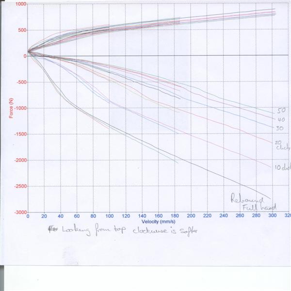

The Ohlins shock has 22 click adjustments for bump and about 60 clicks for rebound.
This is the dyno run for bump adjustment from full soft to full hard:
Ohlins bump adjust
Ohlins bump adjust
ohlins bump (Medium).JPG (34.12 KiB) Viewed 2063 times
This is the ohlins rebound dyno.....adjusted rebound 10 clicks at a time so that you can see the change!
ohlins rebound dyno
ohlins rebound dyno
ohlins rebound (Medium).JPG (38.31 KiB) Viewed 2063 times
Am I right to assume that it shows that the ohlins has a greater range of adjustment and can react to a more subtle amount of force and therefore can be more finely tuned?

bishboy wrote:So what does it mean dontknow.gif
I probably should know/learn this as I have two of them (ohlins shocks that is) :roll:
Yes, the ohlins has a much greater range of adjustment but more importantly, the valving in rebound will have a far greater effect on handling in the slower shock absorber speed range.
