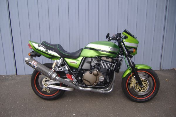

by ezzazrx
Hey guys, this is the yoshi I,ve got . My question is can this muffler be shortened as in the above link?? Cheers EZZA
P.S. I,m asking cause it,s a grand if I start and find I can,t finish.

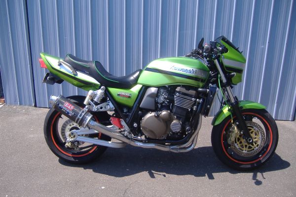

by ezzazrx
Hey blokes, bit the bullet and went for it. Followed the instructions from this forum and all went well, sounds even better.
Cheers EZZA

by fireyrob
That looks heaps better Ezza!

by dutchy
awsome shorty. i like the look of exhausts that don't stick out further than the rear wheel. they're just tidy and make the rear end look way cleaner/less cluttered. :kuda:
