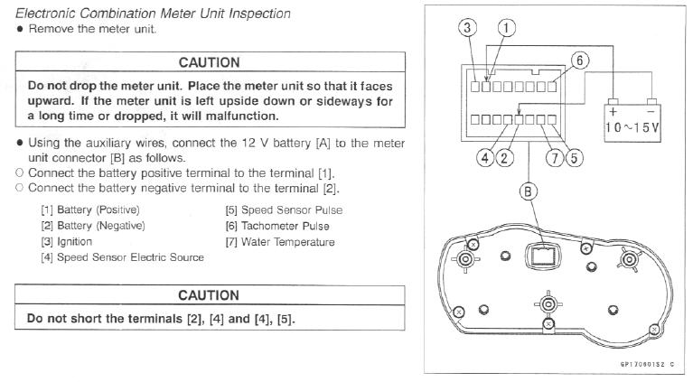

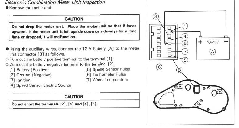

Ive tested the cluster by connecting the battery directly on the cluster. Ive tried to rewire the harness as per the wiring diagrams but still no joy.

I know the instrument panel works as ive tested by hooking it up directly to the battery.

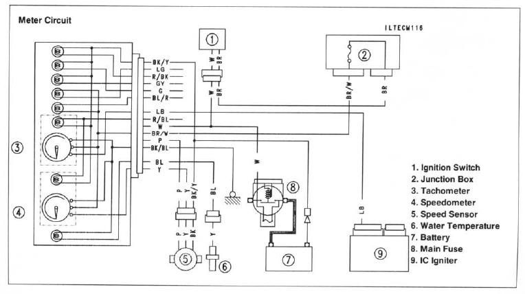

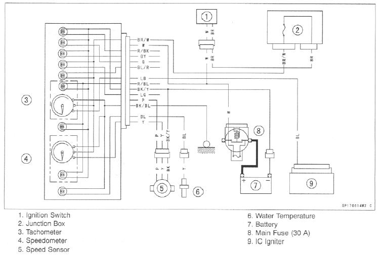

Looking at the manuals it would seem reasonably straightforward, but it seems they've changed the pin order to stop it being a straight swap. From my reading of this (and remember, I'm definitely not an auto-electrician) I think you need to make the following joins in the harness:

98zx9 -> 00zx6
BK/Y  -> BR/W
LG    -> W
R/BK  -> R/BK
GY    -> GY
G     -> G
BL/R  -> BL/R
LB    -> LB
R/BL  -> R/BL
W     -> BK/Y
BR/W  -> LG
P     -> P
BK/BL -> BK/BL
BL    -> BL
Y     -> Y
From memory, the colour-codes are:

The wiring diagram for the '98 zx9r instruments
The wiring diagram for the '00 zx6r instruments
Pin-out diagram for the '98 zx9r instruments
Pin-out diagram for the '00 zx6r instruments
Good luck with it, and remember, I AM NOT AN AUTO ELECTRICIAN and following these directions may completely f#@k your instruments and all the other electrics on your bike. If you do decide to do it let us know how you went.
