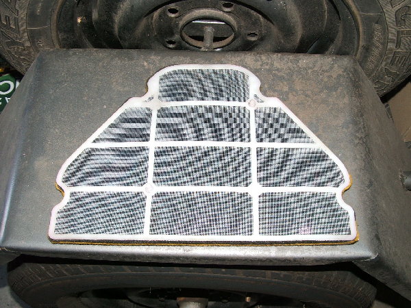

I've just pulled the air filter.
02ZX9R stock filter
02ZX9R stock filter
Hmm, the picture looks better on my screen than it uploaded. Anyway, my mesh is pretty well stuck to the grey layer of filter medium. Removing the mesh started destroying the foam. How much collateroll damage should one be willing to accept? What about the rigidity of the filter without the mesh?? Presumably you keep the plastic grid... I can see a disentegration horror story in the making otherwise...
I see that Rossi in this thread: viewtopic.php?f=28&t=9875&st=0&sk=t&sd= ... e&start=20" target="_blank
says:
Rossi wrote:I agree with everything said except for the air filter............believe it or not hte K&N air filter has 20% less surface area than the standard, that's why the race teams stick with the standard filter, but with 1 minor modification and that is to remove the wire meshing from the top of the filter and then wire the filter medium into place so it can't move about :wink:
Very interesting.
Happy to take advice.
An OEM filter is about $60. Superbikesupply do the K&N for about $85... might go the K&N and do a straight swap and keep the OEM as a spare??
Just regarding the OEM filter, it's clearly not a paper filter. What do you guys do to clean it? Reverse blowing air hasn't done much for mine. Soak it in petrol then dry and reoil???
Rob
Re: Performance improvements for 02 9R
Posted: Sat Sep 08, 2007 3:36 pm
by matt76
Get a K & N, otherwise you will be paying $60 for a new filter every time it needs servicing.
You can get a K & N cleaning and re-oiling kit from Repco for about $20-30
Posted: Sat Sep 08, 2007 4:01 pm
by Robsalvv
matt76 wrote:Get a K & N, otherwise you will be paying $60 for a new filter every time it needs servicing.
Matt, I totally get what you're saying, but since it's a foam filter, I'm thinking it's reusable.
If the weight of opinion on this site is what I think it is, most peeps have stayed away from the K&N and gone with the stocker mod... hence my question, how are they cleaning the filter. To be frank, I've never thought about this point till now. I've always paid for the replacement filter... :? stoooopid!
Posted: Sat Sep 08, 2007 7:38 pm
by SocialSecurity
pretty much all kawasaki filters are foam, wash it with petrol or turps and oil it with filter oil
cant immagine why its stuck to the mesh, but you might have to rejet for a K&N
Posted: Sat Sep 08, 2007 8:42 pm
by Rossi
remove the white plastic grid.......the mesh stays ;)
Wash it in soapy water (petrol will melt the foam !)leave to dry and re-oil it.......the dirty bits stick to the oil with any filter -- stock or K&N
Posted: Sun Sep 09, 2007 10:46 am
by SocialSecurity
its a bit of a wank the old petrol eating filters myth ;) use turps at the very least
Posted: Sun Sep 09, 2007 1:40 pm
by Robsalvv
Well, with a bit more gentle pursuasion the mesh came off. For whatever reason, the mesh was stuck around the edges. Luckily, the damage to the filter foam was limited.
The plastic grid is a sandwich to keep the foam in place, so I've put the filter back with the grid but without the mesh. I'm about to take the bike for a run so I'll see what difference has been made.
Thanks for the filter cleaning info folks. :)
