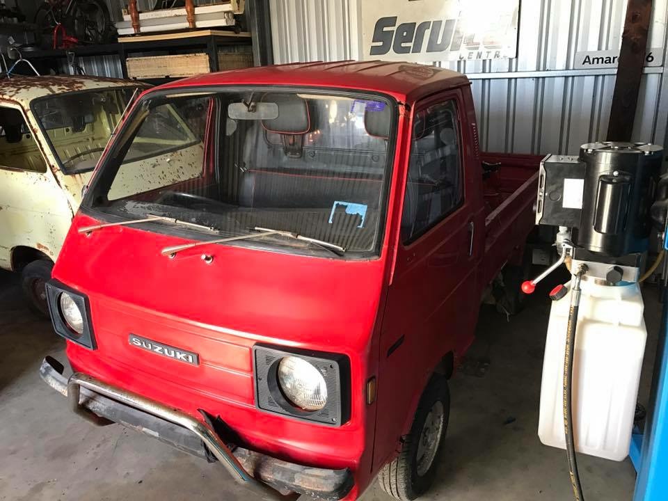

Didn't touch the bikes today, but did have a little impulse buy....
It's kinda like a bike haha
