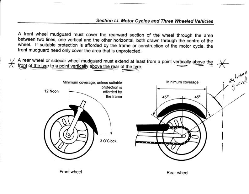

Well I actually did advanced maths at school and spent 10 years as a surveyor, before the computer age where you had to know what you were doing and all calculations were manual, so I think my geometry is pretty good... :kuda:
My point is...
The regulation reads "A rear wheel or sidecar wheel mudguard must extend at least from a point vertically above the
front of the tyre to a point vertically above the rear of the tyre." The diagram in yzr750's link actually shows 45 deg but this is not repeated in the text.
There is a radius (from the axle) where the 45 deg will cover from front of tyre to rear of tyre.
To demonstrate the point take the 45deg line out to double the radius of the tyre and it results in the guard having to extend well beyond the vertical line from the rear of the tyre.
If the rule is as the text shows then drop a plumb-bob from the rear of the FE and if this is rear of the tyre then it should comply (IMHO).
Rear Guard0001.jpg (68.5 KiB) Viewed 1545 times

Yeah I can see that but everyone seems to say the rule is 45 deg.
BUT the written rule doesn't even mention 45 deg, just that it has to cover the tyre from front to back... :?
If you FE complied with that I reckon a good lawyer would get you off.

laidback wrote:Yeah I can see that but everyone seems to say the rule is 45 deg.
Yeah, but the diagram is pretty bloody clear! :lol:

by laidback
Still reckon it's a grey area and as this is a law then it should be clear...the diagram and the written rule should be the same.
Argumentative old fart aren't I... :twisted:
