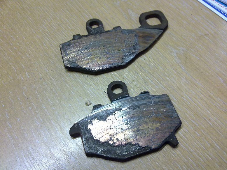

I was going to do the same to the rear one, but when I examined it ... :shock:
Luckily this is one of the few parts on this bike that is interchangeable - and I just happened to have a spare ZZR600 one, so I gave that the Midas touch.
Might have to replace the rotor too. Ah, what the hell - I'll buy a full set of wavy ones from China! :kuda:

That rear caliper is just so wrong . I can't believe how mechanically inept some people are . :x

the kid wrote:That rear caliper is just so wrong . I can't believe how mechanically inept some people are . :x
Great job Daisy
These came off a long time members bike......
Shall he remain shameless? :lol:

Posted: Sat Nov 05, 2011 9:28 am
by ducati_paul
Hang on to 'em for spares ... there's still a bit of brake pad on them! :kuda:

seiko1 wrote:These came off a long time members bike......
More to the point, Why do you still have them? :shock: Image
