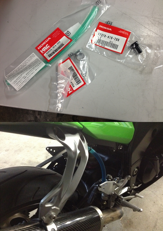

Hi Kwaks,
I want to remove the pillion pegs from the Gumby and I have to mount the rear brake reservoir somewhere. Any ideas how to do it, what with and is there a bracket I can buy.
Thanks again.

I have a spare HCR tube replacement kit for the rear MC...... bought up big as we use them on the race bikes
Will post up a pic

I used clear fuel line from MCA, some plastic fittings from bunnings for the cap and small jubilee clips to hold it all in place!

I have mine bolted into the exhaust heat shield

The kit ready to install, note you can have the tube as long as you want, I need to cut my one down as it a bit too long at the moment ;)

Genuine HRC Honda Racing Corporation Complete Rear Brake Reservoir 4 Parts Kit
http://bit.ly/15e2Oe2
Re: Ideas/thoughts
Mon Jul 15, 2013 9:45 am
Thanks Heaps. That will fit straight to the original MC of the 06 right??
Re: Ideas/thoughts
Mon Jul 15, 2013 9:50 am
Yep straight on
