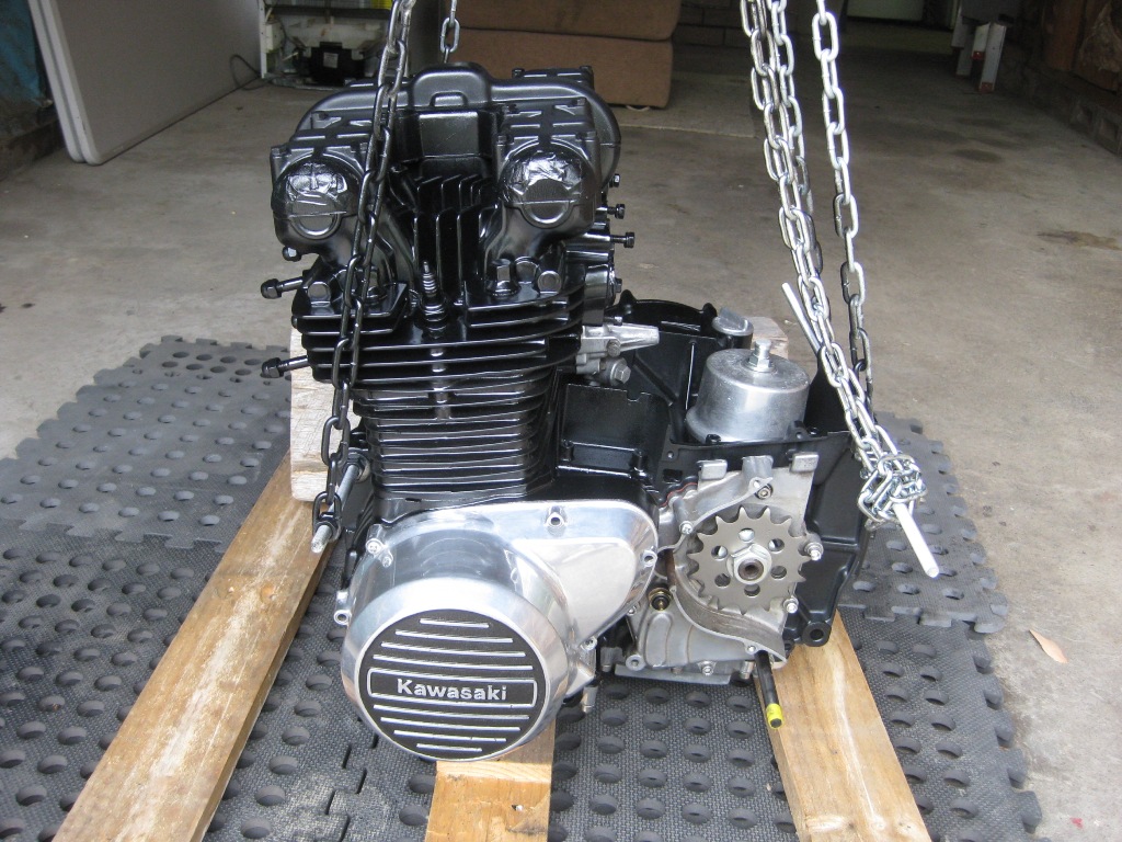

Postby slimey » Mon Nov 09, 2015 9:06 am
Finally managed to get some paint on my Z1-R engine over the weekend.
Previous attempt was a pretty inconsistent and crappy mess so had to rub/scrub the affected parts back (again!)
Anyway got a chain block and some threaded rod and made up a lifting and supporting rig for the job.
Hoisted up the engine, washed it and blew off any dust/moisture.
Masked off the parts not to be painted and checked temp - about 20degC and not too humid.
Applied the VHT engine enamel (satin black) per the instructions and was very excited to watch the paint dry -
came out pretty good, a huge improvement on the previous fuckup!
Covers to be polished and new RH points cover 2b fitted

Postby slimey » Mon Nov 09, 2015 9:15 am
another pic of the re repaint job

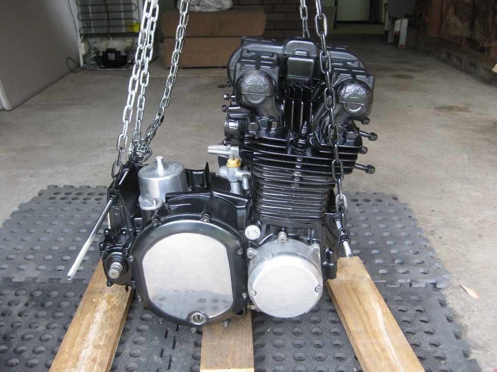

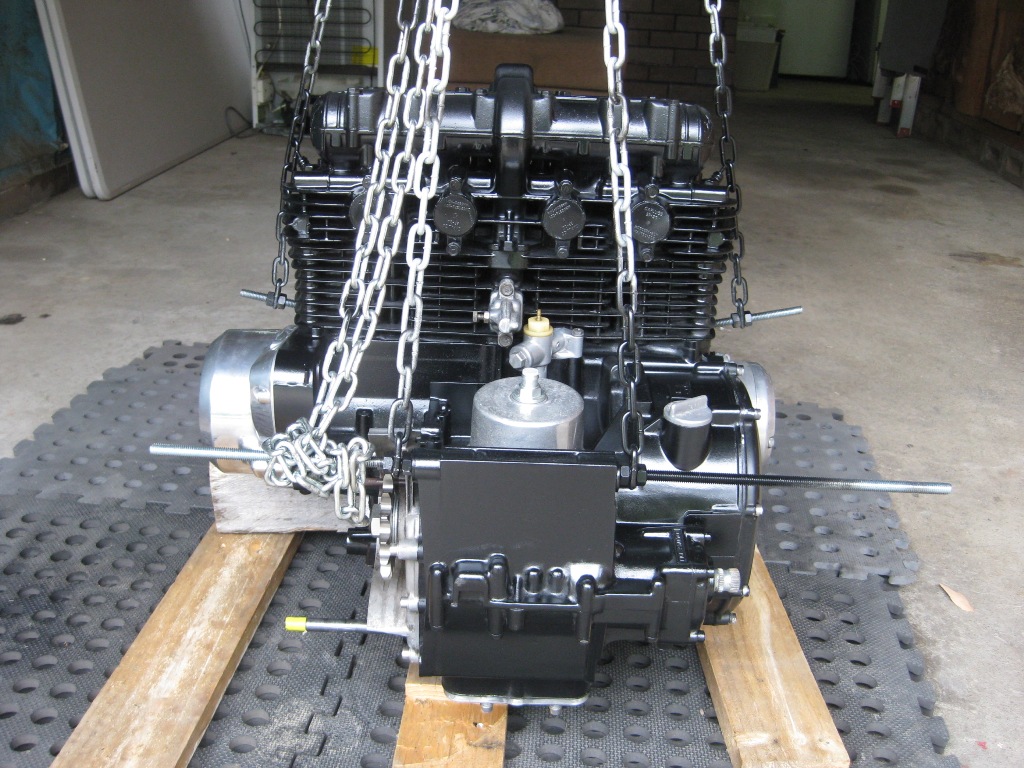

Re: Z1-R Engine re-repaint
Postby slimey » Mon Nov 09, 2015 9:17 am
One more....

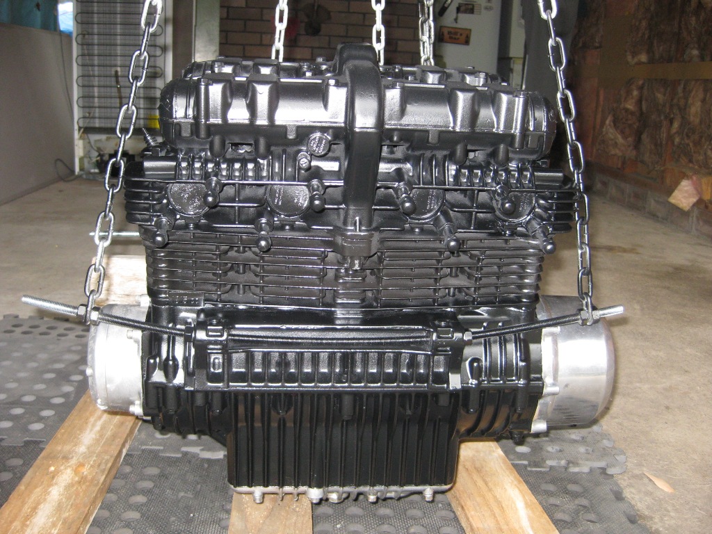

Postby slimey » Mon Nov 09, 2015 9:19 am
Last one ....

Postby BrettZZR » Mon Nov 09, 2015 4:03 pm
Looks the biz!
(-8
