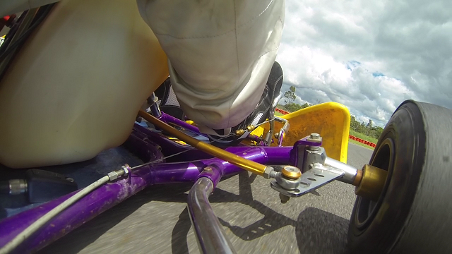

Postby 98ninja » Sun Jun 09, 2013 11:50 pm
Go pro view at cameron park
