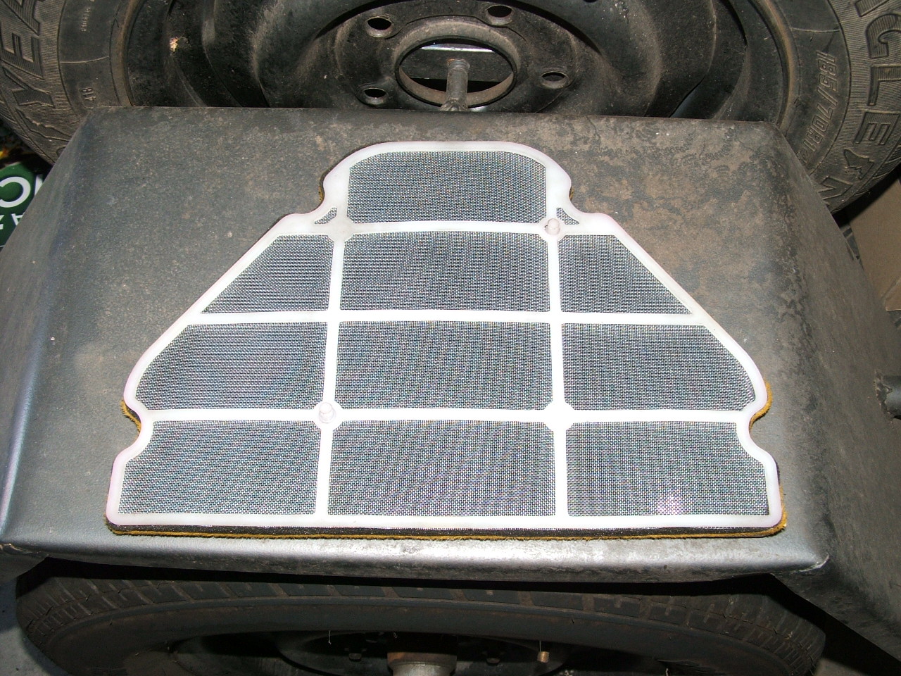

I've just pulled the air filter.
02ZX9R stock filter
Hmm, the picture looks better on my screen than it uploaded. Anyway, my mesh is pretty well stuck to the grey layer of filter medium. Removing the mesh started destroying the foam. How much collateroll damage should one be willing to accept? What about the rigidity of the filter without the mesh?? Presumably you keep the plastic grid... I can see a disentegration horror story in the making otherwise...

An OEM filter is about $60. Superbikesupply do the K&N for about $85... might go the K&N and do a straight swap and keep the OEM as a spare??
Just regarding the OEM filter, it's clearly not a paper filter. What do you guys do to clean it? Reverse blowing air hasn't done much for mine. Soak it in petrol then dry and reoil???

Postby SocialSecurity » Sat Sep 08, 2007 7:38 pm
pretty much all kawasaki filters are foam, wash it with petrol or turps and oil it with filter oil
cant immagine why its stuck to the mesh, but you might have to rejet for a K&N

Postby Rossi » Sat Sep 08, 2007 8:42 pm
remove the white plastic grid.......the mesh stays ;)
Wash it in soapy water (petrol will melt the foam !)leave to dry and re-oil it.......the dirty bits stick to the oil with any filter -- stock or K&N

Postby Robsalvv » Sun Sep 09, 2007 1:40 pm
Well, with a bit more gentle pursuasion the mesh came off. For whatever reason, the mesh was stuck around the edges. Luckily, the damage to the filter foam was limited.
The plastic grid is a sandwich to keep the foam in place, so I've put the filter back with the grid but without the mesh. I'm about to take the bike for a run so I'll see what difference has been made.
Thanks for the filter cleaning info folks. :)
