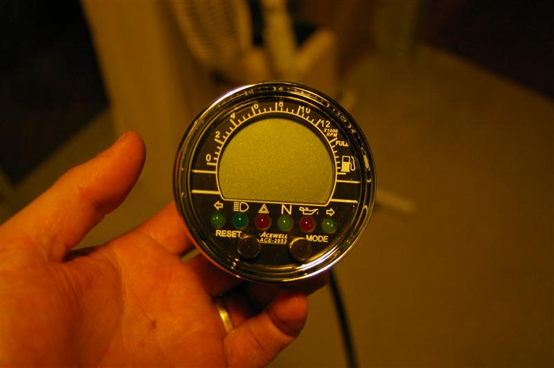

New Acewell speedo arrived today. It'll take some poking but i'm sure that between the factory schematics, speedo instructions, and a little trial and error i'll figure out how to wire it all up when the time comes. :D
It'll be wired slightly differant to accomodate the change from the single indicator dash lamp to dual ones. Also it uses a sensor magnet to gauge the speed instead of the mechanical one. The only thing that the old instrument cluster had over this one is the water temp gauge, but i've got one of them on the way.

Postby oldmate » Mon Apr 18, 2011 7:44 pm
Hey Dutchy you can hook up the fuel gauge on the acewell to the temp sender in the thermostat housing so that cold is empty and hot will show full

oldmate wrote:Hey Dutchy you can hook up the fuel gauge on the acewell to the temp sender in the thermostat housing so that cold is empty and hot will show full
Are you serious?? :shock: That will actually work? :shock: :shock:
Thanks, I might have to try that since i'm not planning on using the fuel gauge.

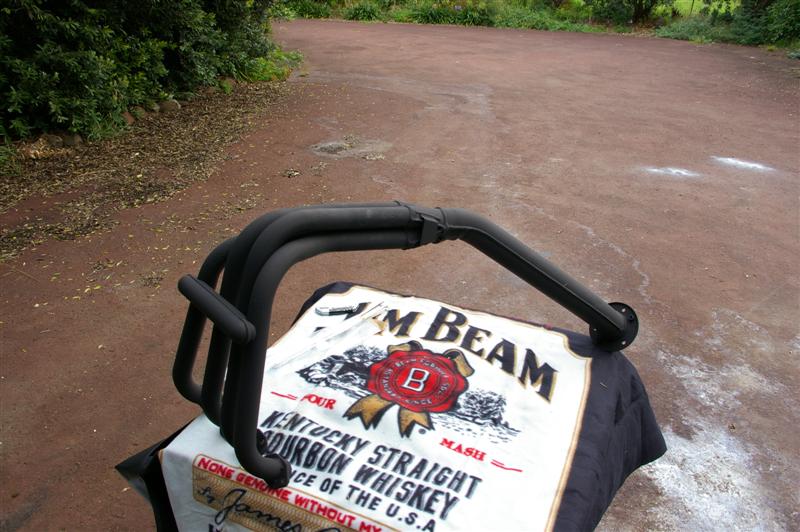

As discussed earlier I treated the pipes a bit with some rust dissolver and then primed and painted. See pic.

And then added the first of "some of the cheapest shit I could find". It's an Ixil pipe with removable baffle (now removed). It bolted straight on to the stock tri-bolt flange, after some minor adjustments involving a drill. The holes didn't quite marry up so a quick little bit of drilling/filing was required. All good now. :kuda:

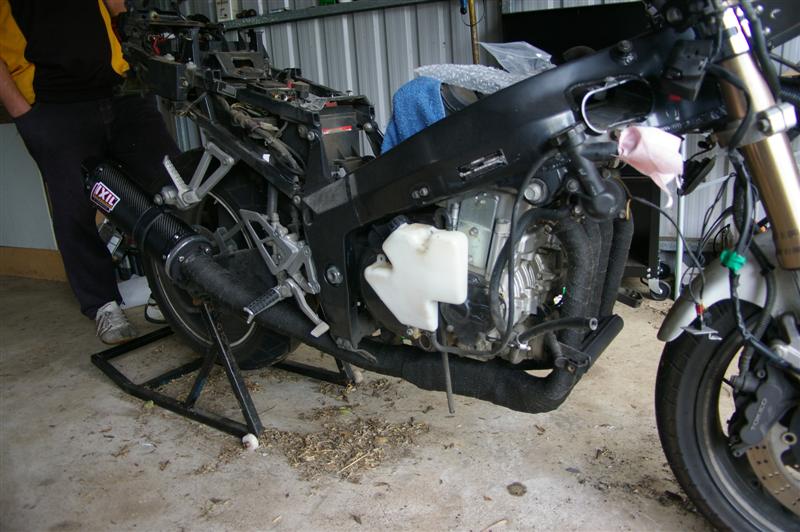

Here's the finished exhaust. No idea how it sounds yet as I haven't re-connected all the magic electrical wires. Hopefully that'll come over the next few days. If it doesn't happen over the next few days then i'll be spending all day Saturday drinking bourbon and working on it, but not in that order. :D :D :D :D

Just out of interest..
Have you had any thoughts on where the radiator overflow bottle will go as of yet?

Postby dutchy » Sun Apr 24, 2011 8:10 pm
Supafrog wrote:Just out of interest..
The thought so far is to replace it with an alloy drink bottle and attach it to the side somewhere. I've seen people using everything from soft drink cans to home made cylinders with sprockets welded to both ends :shock:
It'll be attached down the side there somewhere. Worst part about that will be that the mounts for the original overflow will probably stick out like dogs balls on the side of the engine........meh.
