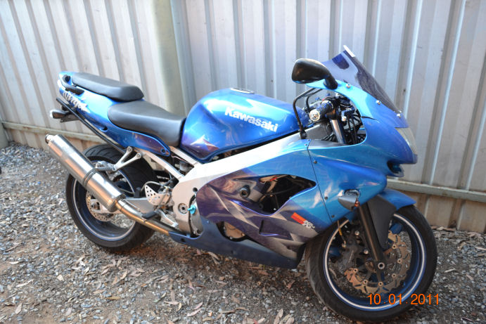

Postby seiko1 » Tue Jan 11, 2011 6:00 pm
That would be this one :D

Postby MadKaw » Tue Jan 11, 2011 6:22 pm
Nope that motor doesn't fit but the previous model one might.
I believe the 93 to 95 zx9r engine is the go.

Postby Kwak addict » Wed Jan 12, 2011 10:30 am
ZXR 750 L engines are the same as J models externally so will bolt straight in (& give you an extra 15+ HP)
ZX7R engines will not fit without a lot of fabrication & modification.
ZX9R B model engines will fit with very minor clearancing mods to the top mount on the cylinder head casting & frame webbing as per MadKaw's link.
Go for the 9 if you can get one, the torque boost is a thing of beauty & you'll be blessed with around 40 more horses than the 750 J & because it's a 9, each one of those horses has the grunt of a Clydesdale & the speed of a thoroughbred Stallion :kuda:
If you do go for the mighty 9 POWERplant, use the 750 L 38mm carbs instead of the stock 40s, tons better bottom end, midrange & throttle response & you'll never notice the 3 or 4 HP you lose @ 10K+ rpm.
