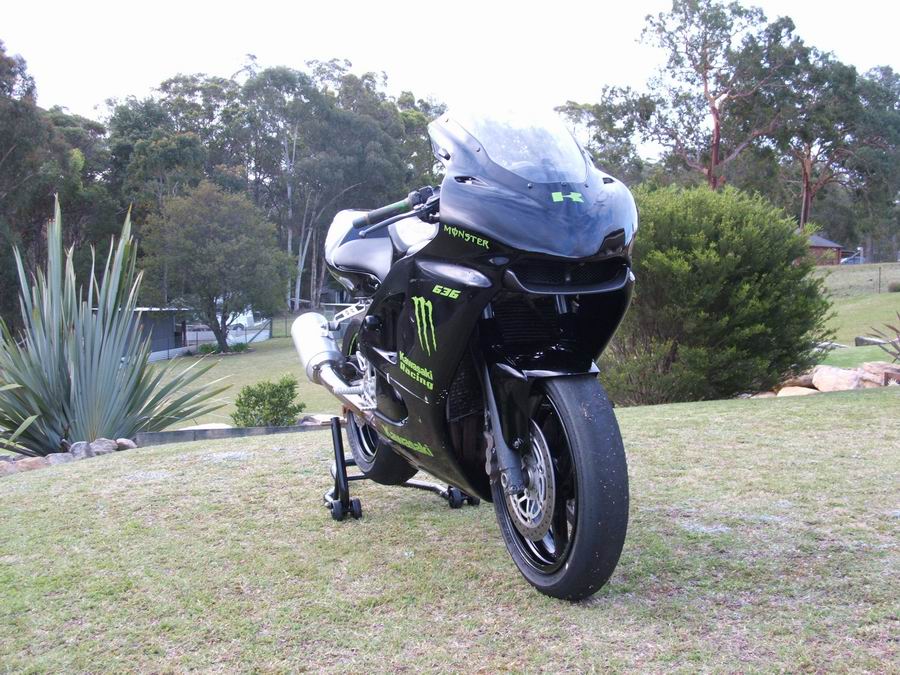

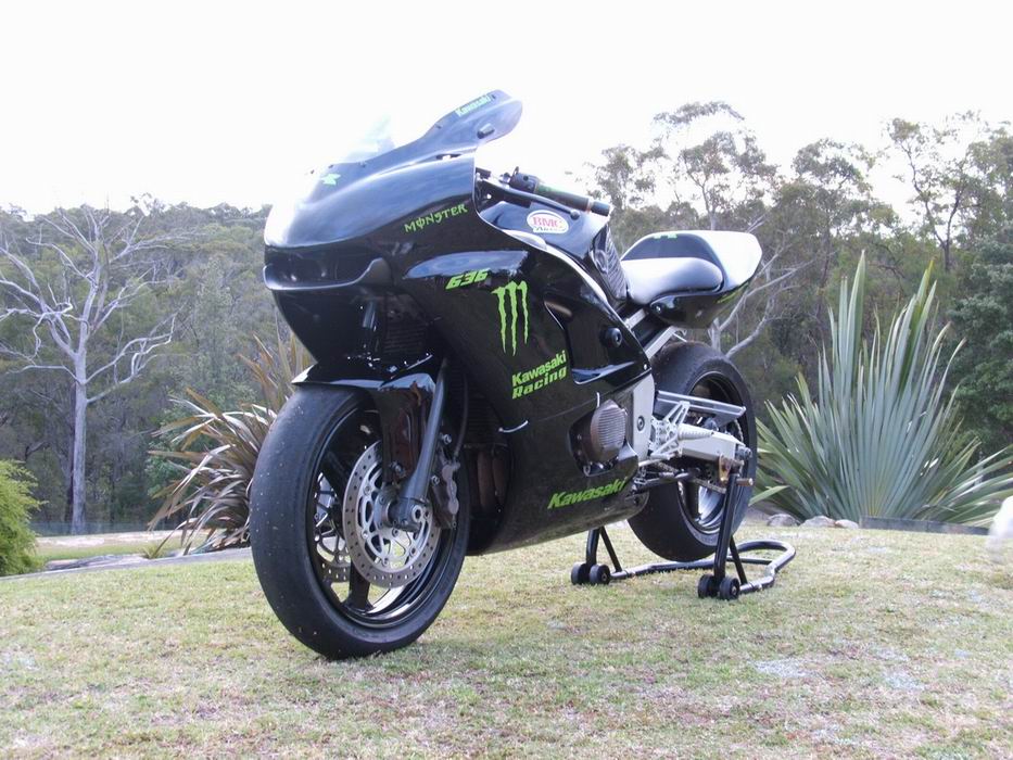

Got any pics of the tracky? i've got the same ride but its all road... be nice to see what mods you've done for extra power.
Had it dyno'd at 103.4hp :)

The mods were done by a race set up mechanic for the previous owner....... I picked it up as is...... Mods include......
Billet alloy adjustable rearsets, BMC air filter, wet4u race glass, Acumen gear indicator, stock exhaust, well it was before it was cut in half and had the guts removed :shock: :lol: Only thing i've spent money on is servicing, tyres and suspension adjustments.......... oh and now a 2nd hand coil $100
