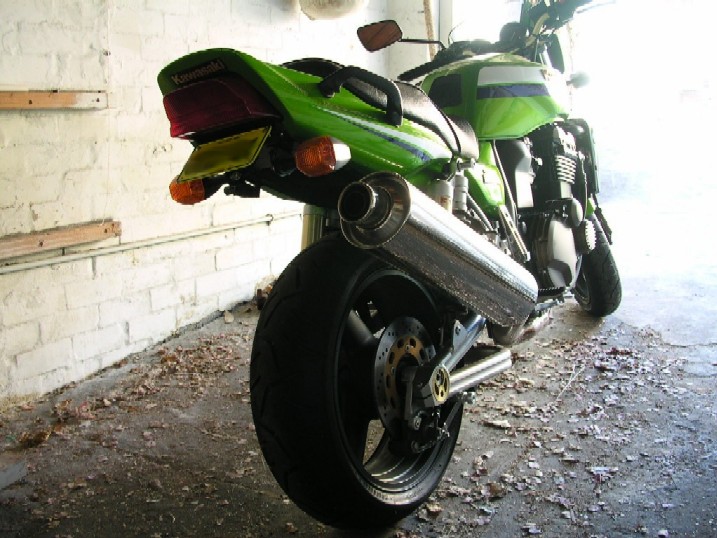

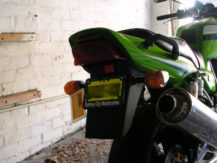

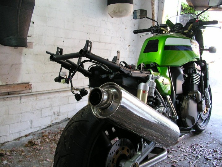

Postby matchan » Sun Jan 31, 2010 9:12 am
I can show you a before and after for the rex but i didn't take any of the process but I don't have any at all of the 97 zx6.
On the rex I actually removed the whole guard assembly which was a reasonably time consuming job, then cut the entire mudguard bit off. I got a number plate holder to attach to the bottom of the guard to hold the plate and indicators.
On the 6 I just marked it with a paint pen and cut it off using a hack saw blade then tidied it up with a file.
If I were you I would just cut it just beneath the numberplate bracket.
Matt
original
undressed
new

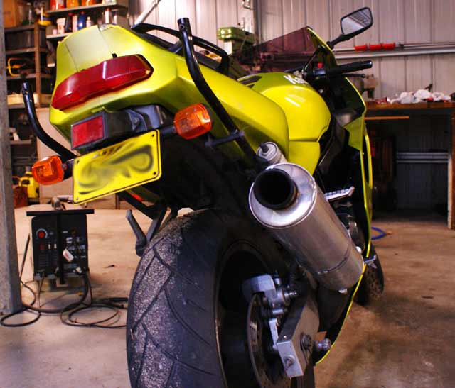

Postby freestyler » Wed Feb 03, 2010 6:02 pm
half way through it, jigsaw is much easier than hacksaw, cuts like butter, now to make the bracket up and new number plate light.

Postby freestyler » Thu Feb 04, 2010 5:57 pm
Couldnt cut as much off as I wanted to, as it would have left the rear storage compartment open.
