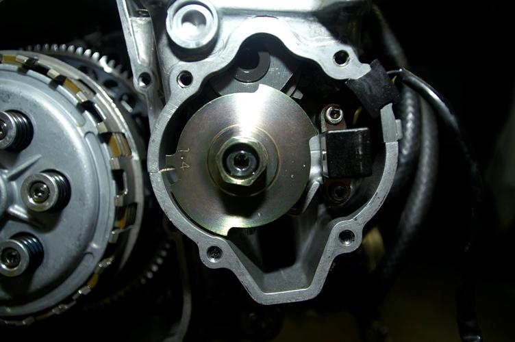

Thought I'd take a photo of mine while you guys are talking about it. Has 1.4 written on the side.....Not sure if this means +1.4 deg or 4 deg. It's not the 96 kit part as in the manual. Apparently they had differnet cranks / harness / timing on the 2000 model (which I have.) Here's a couple of pics anyway.

zx793rr wrote:......Thought I'd take a photo of mine while you guys are talking about it. Has 1.4 written on the side.....Not sure if this means +1.4 deg or 4 deg.....]
It means TDC for pistons #1 and 4.

Postby zx793rr » Tue May 20, 2008 1:07 pm
Cool, at least I know what the 1.4 means now....didn't even think about that.

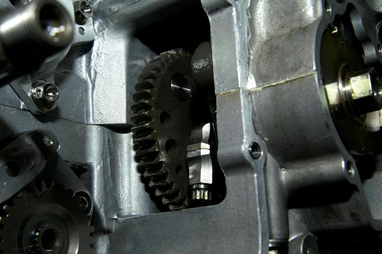

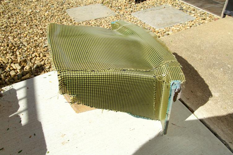

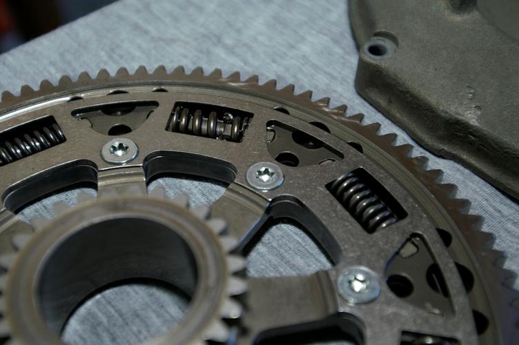

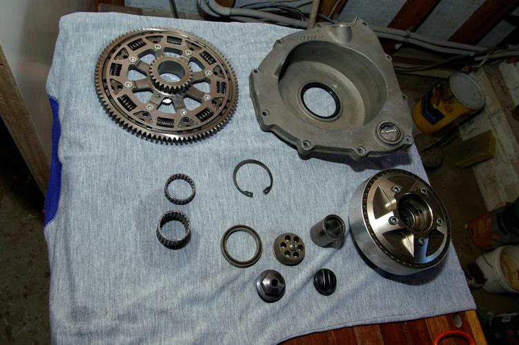

Build is getting back up to speed. I'm just in the process of throwing the dry clutch in. I noticed one of the small springs was broken so I still need to find one of them. One of the teeth is missing on the oil pump drive as well but even though it still works, I'll try and fix that as well. Just been stuffing around with the carbon kevlar radiator shroud as well. Working out whether a single layer or dual layers will be needed. I think two layers will be fine. Pics ar of the test pieces only...ran out of kevlar so I couldn't do it in one piece....but you get the point. Just needs a good trim and some holes for forks / brake hose etc.
As for spares.....no rods / cranks etc.....they probably wouldn't work without the correct ecu. Aparenlty the 2000 crank needs a certain timing rotor and electrics. Can't even help you with the spare clutches I have. They won't suit the chain drive and you'd need the gear driven oil pump......rocking horse shit seems to be easier to find.
