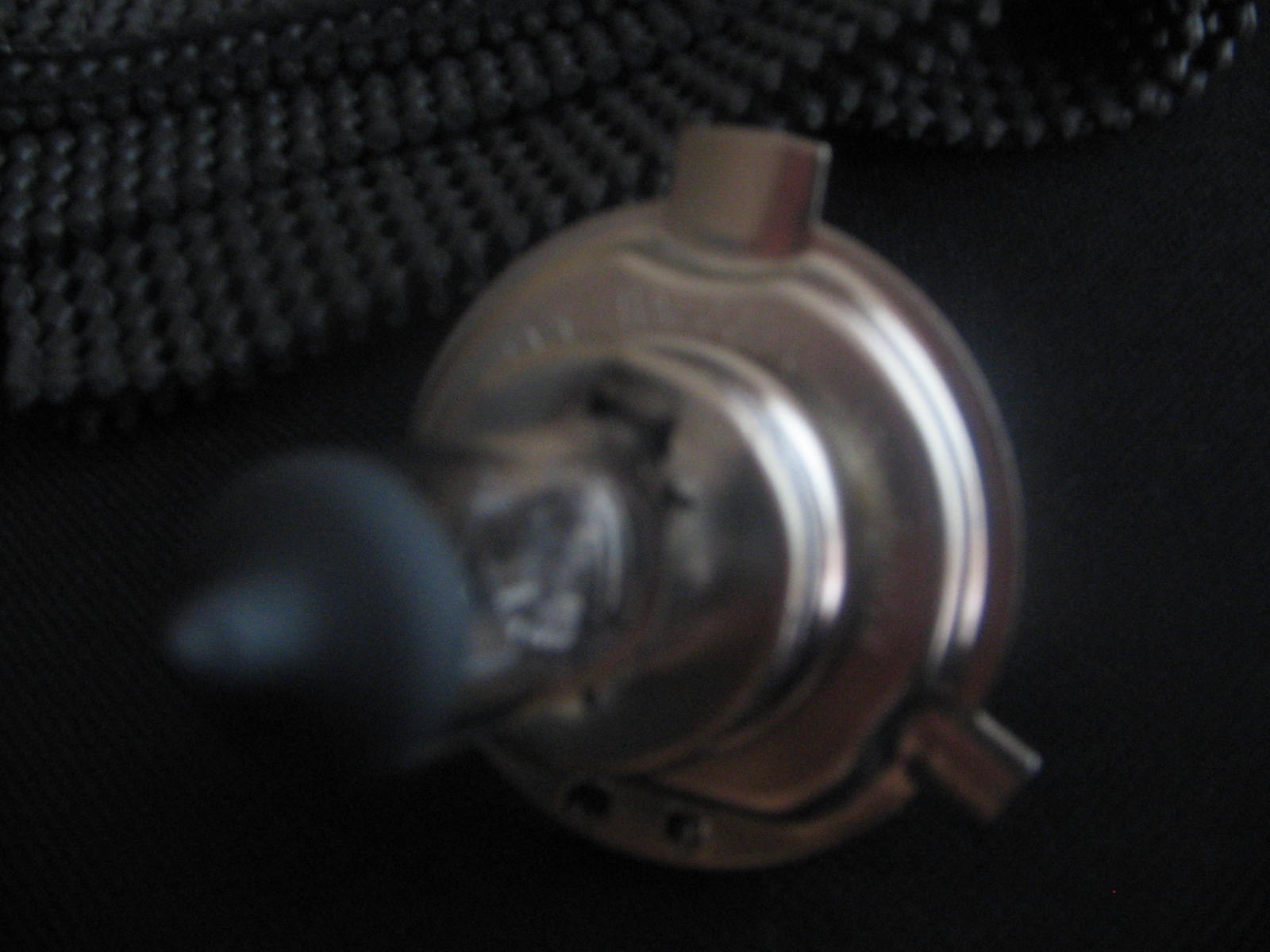

Postby hutsy » Thu May 31, 2007 12:07 am
This is the offending bulb,It has no H markings and the two lower pins are different to standard H4s.Anyone have any ideas? :?:

Postby ZX10R King » Thu May 31, 2007 4:41 am
Have you tried an H3?

Postby andrew.k » Fri Jun 15, 2007 3:14 pm
I had the same problem with my old 7.
Just cut off one of the lower pins with a pair of tin snips. Problem solved.

Postby hutsy » Tue Jun 19, 2007 4:22 am
Have found a soloution .If anyone finds themselves in the same situation California sport touring inc. make shims which solve the problem .cheers for all the help.
