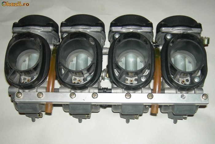

Postby NINJAINOZ » Wed Jan 16, 2013 8:52 pm
Do your carbys look like these>
Or these?
I will stick with foam filters, As you mentioned the K&N & similar filters are known to let fine dust through & cost too much

From memory the flat sides are in the RR model and cost a fair bit!

Postby NINJAINOZ » Wed Jan 16, 2013 9:42 pm
Lots of people mistake the CVK's for flat slides because the vacuum slides look similar to the slides on the FCR's
Yeah the ZXR 750 M1/M2's had the flatslides
http://homepage.ntlworld.com/webzxr/zxr750r/

Postby willrcr15 » Thu Jan 17, 2013 8:24 am
Looks like I've got the standard carbs.
