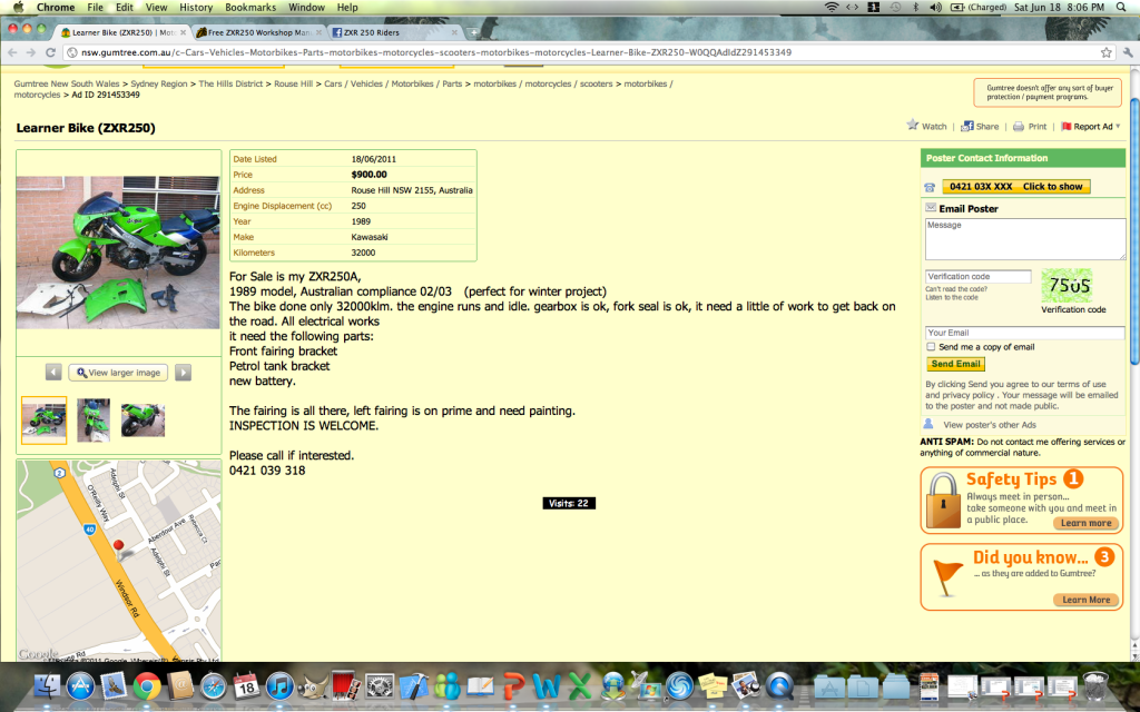

Looks like it Damon, but Mike is right, she was stored in a shed in a backyard somewhere in south sydney for 2 years, and the fairings were off. I'll post up a pic of the original ad on gumtree tonight when I get home.

Here's that ad by the way:
