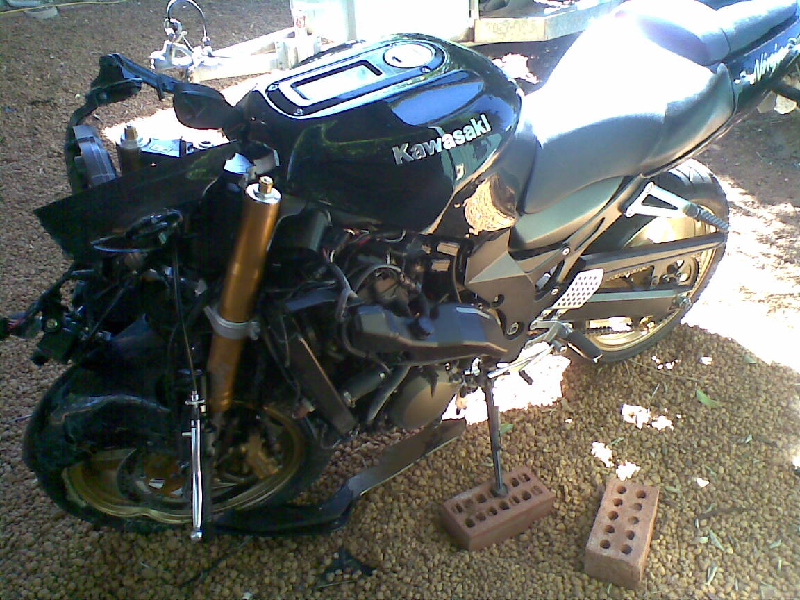

2. As mentioned , has the bike been binned ?? ie cracked headstem / weld / bearings (see pic)
3. Wheel bearings OK?
4. CORRECT wheel / bearing spacers?
5. Irregular tyre wear / scalloping / out of balance?

Postby Gosling1 » Wed May 06, 2009 12:18 am
:shock: jeezus that hit something hard !! snapped the fork right out of the top clamp......bloody ! :shock:
heh Councillor any update on what this problem was ??
