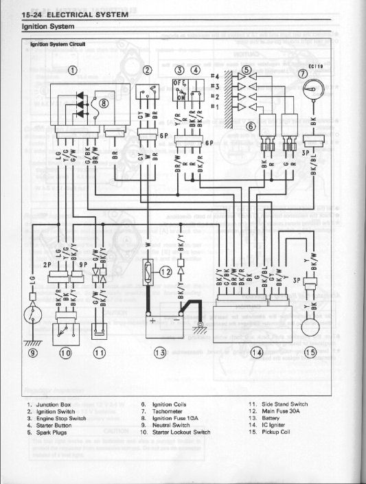

I would appreciate a schematic if any ones got one?

Postby oldmanmike » Tue Jan 05, 2010 3:14 pm
Had a similar problem with my B1 when I had it. Turned out to be a dead/dying diode in the junction/fuse box under the seat. You have to pull it apart to get to the diodes. There are 3 in line in the start circuit (G/BK - BK/Y ).
I have the B manual as a pdf. 133MB so you would need to give an addy for cd & snailmail if you want it.
ignition diagram_zx9rB.jpg (75.67 KiB) Viewed 1911 times

oldmanmike wrote:Had a similar problem with my B1 when I had it. Turned out to be a dead/dying diode in the junction/fuse box under the seat. You have to pull it apart to get to the diodes. There are 3 in line in the start circuit (G/BK - BK/Y ).
