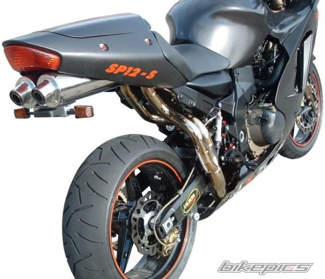

You mean like this one? :shock:
ZX12R High Pipe.jpg (52.96 KiB) Viewed 3309 times

Postby Blurr » Thu Aug 26, 2010 1:12 pm
that look hot for a barge
Re: ZX12R High up exhaust?
Postby frozzie » Thu Aug 26, 2010 3:16 pm
Looks like it can be done. Do you know the brand of exhausts? Has the rear been jacked up a bit?

Postby Che » Thu Aug 26, 2010 3:31 pm
It was a UK site... :shock: Google zx12r underseat pipes

Postby Gosling1 » Thu Sep 09, 2010 8:35 pm
each to their own, but as a ZX12R owner, I think those under-seat pipes look shithouse on the Barge.
Have a look at the footpeg. Then imagine riding that bike, with your toes on the pegs. You would burn right through the inside/rear of your right boot, or ride with your right foot poking out at 45deg from the peg !! Totally impractical. Apart from that, you would lose all the storage area under the seat, and from the looks of those tail-pipes, the ECU would also need to be relocated.......
They just look.......wrong - on that bike.

Gosling1 wrote:each to their own, but as a ZX12R owner, I think those under-seat pipes look shithouse on the Barge.
+ 1 :roll:

Postby Phil » Tue Sep 14, 2010 7:59 am
+2 underseat pipes look shit on the 12. ;)
