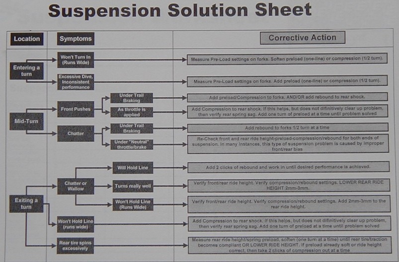

Suspension need adjusting.. Smitty remember that suspension chart you posted ?? Thats how i set up my 12 and got good results from it..
The 14 i knew what i was doing and just fiddled until i was happy.. As smitty says they are set for 68kg riders..
Here is the chart ..

i gave hoffys suggestion a go and it got rid of the head shake it turns quite good now but still dives excessively under brakes. i think thats more of a spring and oil problem though.
it also runs a little wide so ill use that chart.
