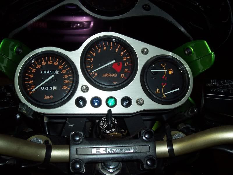

Well first mods are done,"S"gauge's are on[ just couldnt ride a water cooled bike without a temp gauge]

'S' gauges look great - plug and play?

Hey S man, what did this mod cost if you dont mind sharing, was it easy to add the temp gear?
Whickle
Posts: 603
Re: Hi new to ZRX's
Postby s man » Tue Apr 13, 2010 4:10 pm
Whickle wrote:Hey S man, what did this mod cost if you dont mind sharing, was it easy to add the temp gear?
I just searched the wreckers & Ebay & found a "S"model dash at the right price. Made some brakets, fitted the "S"temp sender unit inplace of the "R" in the thermo housing, removed the trigger for the "R" temp light & Bobs your uncle. Took about 1.5 hours all up.
