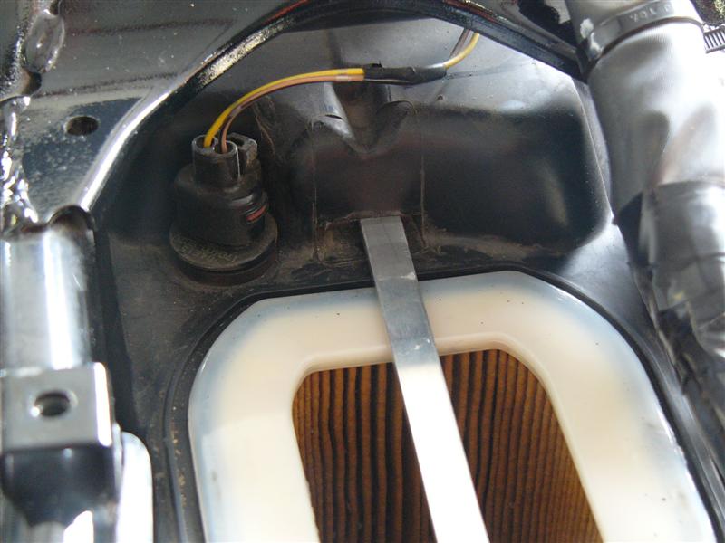

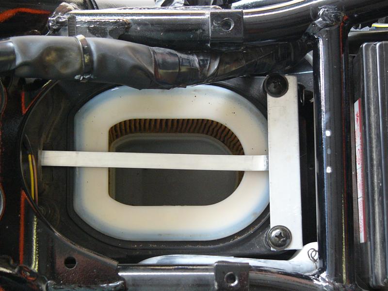

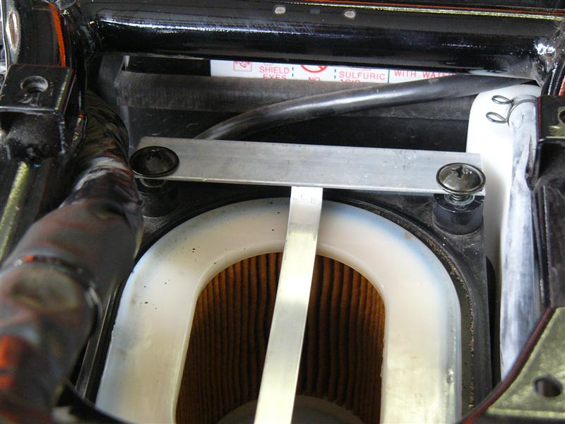

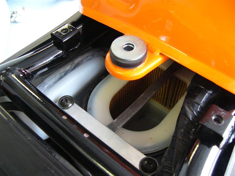

I have seen a couple of mods for the restricted intake on the Z1000, but this is how I did mine. The photos are with the original filter so it is easier to recognise. I am now using a K&N filter.
1. Take the lid off the airbox.
2. I have used some aluminium strap which is 10mm wide which you can buy from Bunnings. One end is pushed into the airbox lid location slot at the front.
3. I have used aluminium angle and the original screws at the back of the airbox.
4. Make a bend in the strap at the angle end so it will apply pressure when the angle is screwed down.
There you have it a very simple and effective mod, no need for the lid therefore no modifying the original lid, so you can put it back on when you want to sell the bike.
I have been using my bike like this now for about a month with no problems. The only side effect is a loud growl when you crack open the throttle.....mmmmmm sounds sweet.

Sat Jun 09, 2007 5:13 pm
thats good, but what happens when it rains??
the water will run down the tank and into the paper filter and it will fall apart.
i left the lid on the box, but opened the hole right up.
no problems in the rain
Sat Jun 09, 2007 5:24 pm
I rode in torrential rain from Jindabyne to Canberra and didnt have a problem. I dont have the stock filter anymore. I put in a K&N.
Sat Jun 09, 2007 5:56 pm
fair enough then :)
