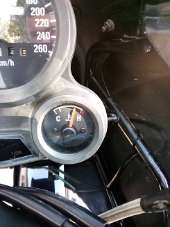

Still suspicious of 110 degree switch I swapped it out with one that I had tested working. My second complete bike had a broken one. Turns out that my original one tests ok too.
Let the bike get 'hot' on the drive while running. Just been riding through traffic and gauge was high but not high as pictured. This is the point where the bike switches the fan on- 110 degrees, verified by infra red temp gun. This is still some way from boiling so maybe the gauge is ok.

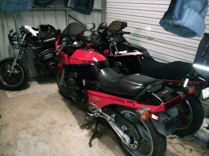

Now have a 88, 89 and 91 GPZ900R. :) Will be interesting to compare new model once I have it running/riding. I rode one 23 years ago a bit.
