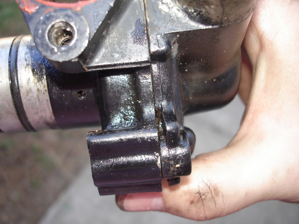

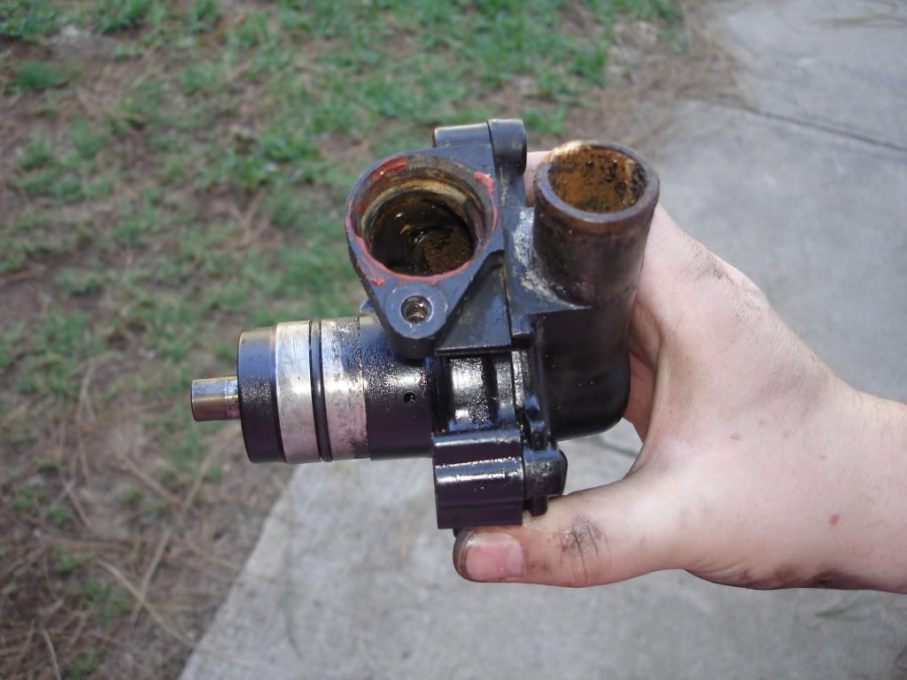

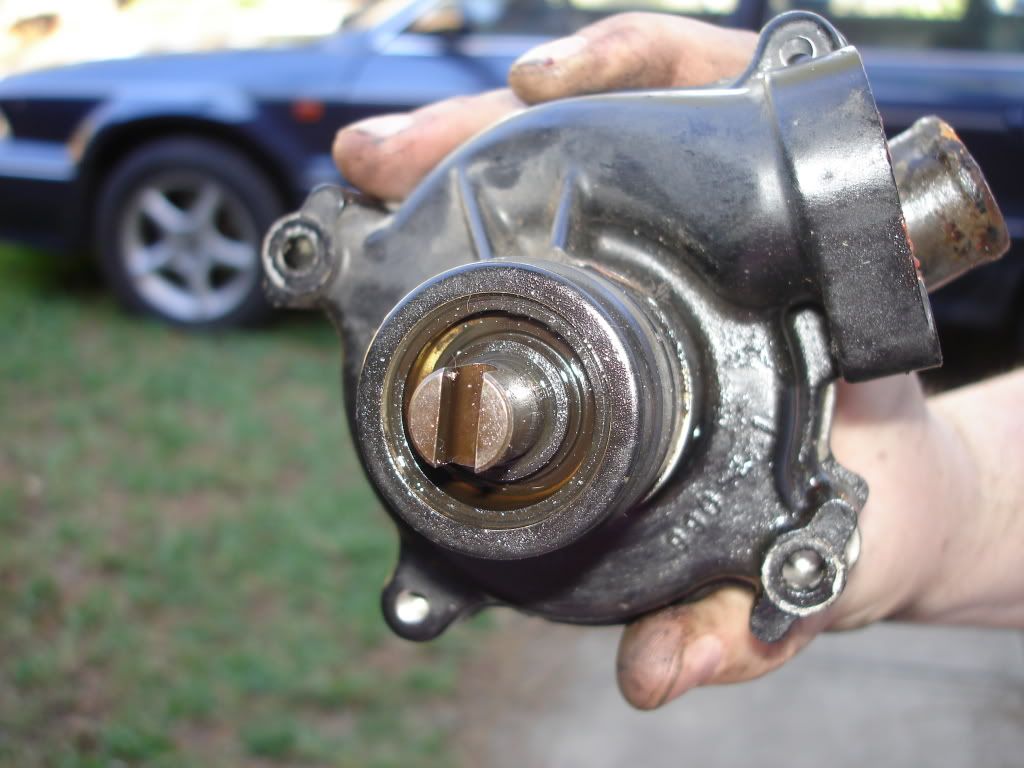

Hi All
I have a 1984 GPZ900 and while doing an oil change i located a oil leak coming from the top left side of the water pump. It was dripping out, so not good!
I have read some posts about replacing the oil seal to fix this. Is the seal the one around rear of the body of the pump or in the section that connects to the oil pump?

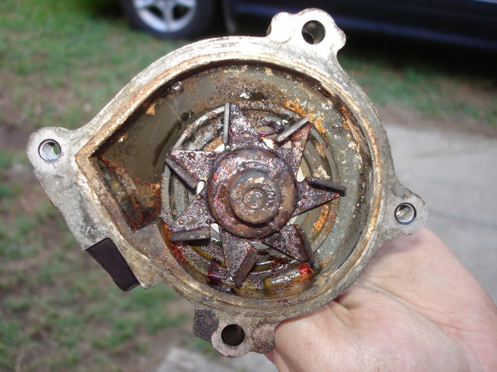

Also there was some gunk/corrosion in the pump itself.
Some pics -
CHEERS MICK

For the parts i just rang the local Kawasaki shop and asked for water pump gaskets. You need the water pump gasket, outlet pipe oring and the rear oil seal on the pump. Cheap parts. New water pump was quoted $450 :shock:
Did mine but it still leaks a tiny bit so may have to do again. Have been told you should use some grease on the oil seal which i didn't.

Re: GPZ water pump oil leak ---
Postby JetPilot » Tue Feb 10, 2009 12:07 pm
Can I just say that when the water pump leaks oil and coolant, this is a sign that its stuffed.
There is a tell tale hole at the bottom of the pump, when coolant leeks out ONLY, then the seals just need to be changed near the impeller.
If oil and coolant leeks out this hole, the ENTIRE pump needs to be replaced as the seal on the shaft that goes into the crank case is stuffed.
This can only be replaced with a new pump.

Postby GPXtim2 » Wed Feb 11, 2009 6:01 pm
Yeh Rod's correct, the same thing happened to my GPX pump and I needed a new pump because the parts to repair it wernt sold seperately that was a few years ago mind you at $400 odd that was a bit much I thought.
My mechanic who built my engine had the seal area machined to take a common pump seal and this worked for 20K klms until it started leaking, but as seeing it only costs $50 to do it was worth, got the seal from repco.
Speaking of repco its worth going down there to see whats available as there may be an alteranive thats heaps cheaper than genuine.
