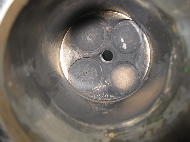

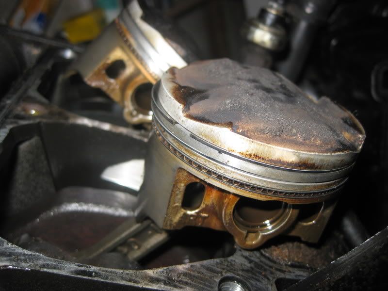

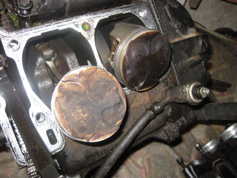

tried to get a close-up of the piston rings
valves, both cylinders are in pretty much the same condition
piston head
piston gasket
reverse side
the piston gasket is obviously blackened, which on a car means blown gasket so i assume its the same on a bike. one spark plug was burnt white and the other was jet black. is this a case of new parts or acid bath? (obviously i'll need a new gasket)

the amount of oil means either theres a load of oil in your airbox (check it) coming from the one way valve from the air recycling.or oil came in via the oil galleries. I would put my money on the latter though. lastly how was the oil or coolant? any indication of cross contamination?
Re: 1989 gpx 250 blown piston gasket - major edit- pics added
Postby Martin » Thu Mar 26, 2009 11:44 pm
oil was black (newish oil too), coolant clear green, but the stuff that came out of the bottom of the radiator was naturally browner, normal i guess for an old radiator
Martin
Posts: 44
Joined: Wed Sep 03, 2008 8:28 pm
Location: Burwood, Melbourne
Bike: GPx250
Postby mike-s » Thu Mar 26, 2009 11:46 pm
well sounds like time to flush the radiator at the least as well as clean the barrel and head faces and check the runout with a set of feeler guages and a steel ruler.
