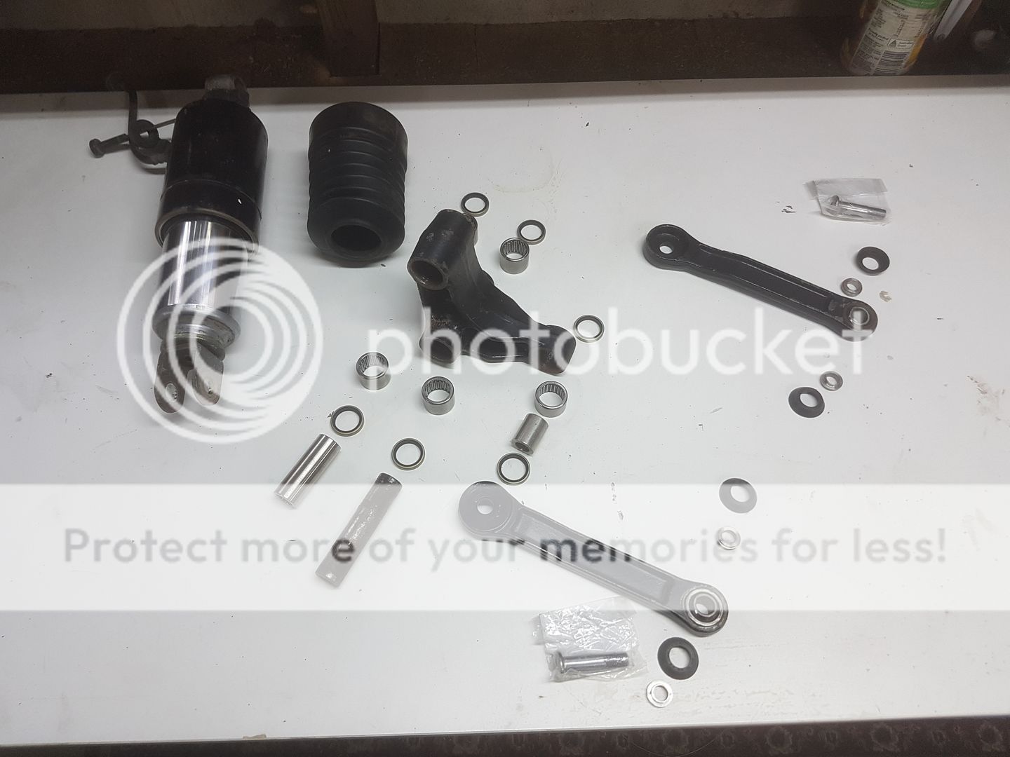

Finally got the parts for my Unistrut knuckle made up.
The 3 sleeves to go in the knuckle along with the metal grommets to hold the dust seals over the spherical bearing. These parts are no longer available, so had to get them made using the old damaged bits as a guide.
Sleeves were straightforward, the parts list gave all the details, but the grommets took some figuring out. That and it took the machinist about a month to get around to it.
Now I can start putting the frame together! Been stuck with work and getting some major servicing work on one of my cars, but that's done. Just have to clear up the mess and get started.
