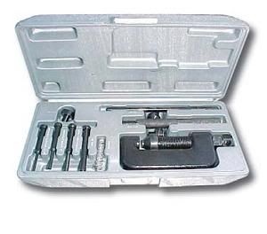

Dave do you know what you are doing?
Have you got a set of these:
Cam Chain breaker kit
Chain breaker pin
