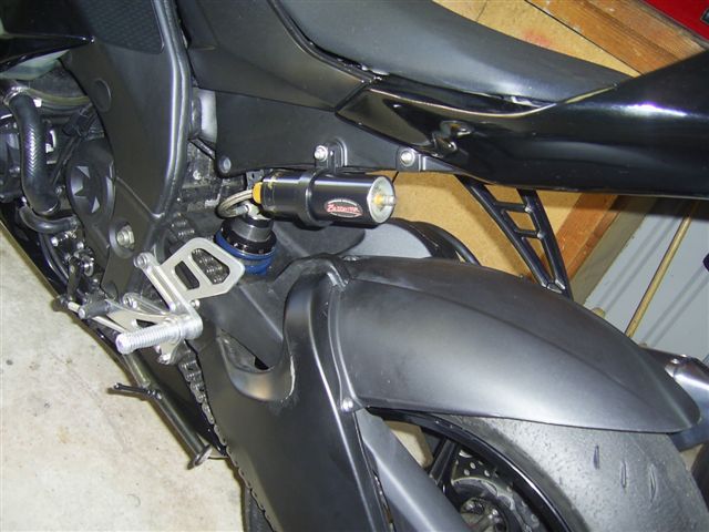

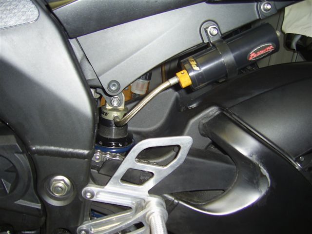

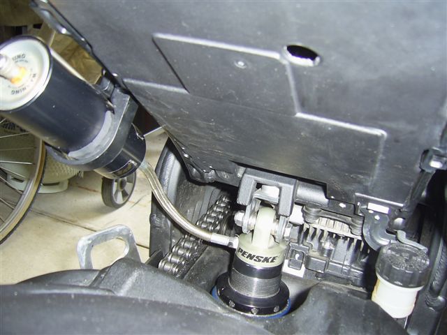

I have now replaced the stock rear shock with a Penske shock. Same spring weight (9.17) but with much more adjustment, ride height adjustable and better valving. I am sure that it has to be better than the stock one for sure. ..!! So it's been installed in the bike, ride height set as per standard, as I am used to that, and everything else set in the middle for a start. I cant wait to test it out on the 10th and 11th of Feb at the island. Just got to get the sag set first and I am off...
I have also done the new brake pads, got rid of the exhaust servo with a 'servo buddy' so now plenty of room for the power commander... and I am even thinking of getting rid of the air induction pump as well.. just to clean up that area.. I currently have a marble in the hose, but if I am not using any of this stuff it would work better if I got rid of it completely..
So the bike is looking and feeling really good so far.. next update will be onthe rear shock in a couple of weeks.. here are some pics of the install today... It fitted perfectly.. just had to make a few small adjustments to the reservoir holder, but apart from that it was a very easy install....

Postby Maccarocks » Wed Feb 02, 2011 11:52 am
Taj, the eye to eye length is exactly the same.. 338mm
This one I can only wind down to 335mm, but it goes up another 15mm (that would be at the extreme end of adjustment though)

Postby Maccarocks » Sun Feb 13, 2011 9:01 am
OK, back from a couple of days at the island testing this new rear shock...
All I can say is excellent..!! Did the sags immediately and it was already perfect, set up with slightly less sag than the stock one by 5mm, so I was happy with that. I set the rebound and compression exactly in the middle of the range and started off with that.
This shock felt perfect right from the start, less squatting, which I could feel especially when exiting turn 12. The bike is just feeling better every time. SInce changing the front fork springs to Ohlins, this has made the front feel way better than stock, and my times have continually dropped. Now the rear is even better, my times have dropped again.
The new rear shock has also changed the feeling in the front slightly, so I will just keep tweaking until I get the match right, (although I have been advised to top the fork oil up an extra 5mm) but I have to say that I am very happy with the results.
