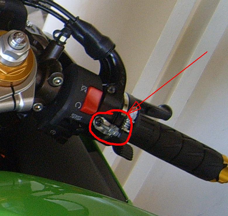

Postby MrStompy » Thu Aug 03, 2006 10:00 pm
Hey Evil sim
I just went up to MCS and picked up the same Control as you have.
See the modified picture below. What did you use to mount it to the throttle cable housing like that (or did you just make that up yourself?)
Also did you have to move your brake lever, switchblock or anything?
sorry for all the questions.
whats this

Postby evilsim » Fri Aug 04, 2006 7:43 am
MrStompy wrote:Hey Evil sim
Yeah take off your throttle hand grip and slide the 'collar / slipring assembly' over throttle. May need to trim just a little bit off your hand grip to make it fit just right. Slid it back on then. Dont use the 'bar clamp' that comes with the kit. Make a small metal bracket to lock 'collar / slipring assembly' to your throttle cable section next to hand grip using existing screws ... all done. No need to move brake lever ect ...
