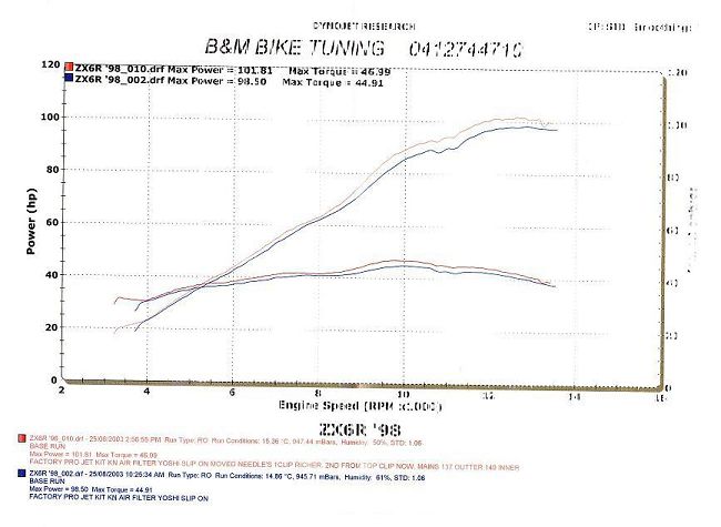

fitted jet kit to 98 zx9r + dyno graph

Aussie Ninja wrote:Nice one. I know it costs money but you need to get her back on a dyno to get it exactly right. Not that I can talk 'cause I haven't, but I'm sticking with the excuse that the nearest one is currently 7 hours away.
mate.... I know there is at least one dyno in canberra.... @ RObbo's and I think Axle's has one also..... ***paging gos....

That's an oolld post, from when I was living in Rocky. I've been to Axles and ended up with 102.
