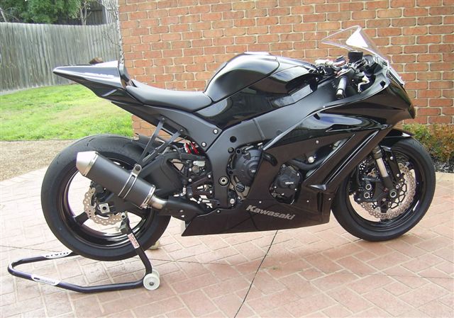

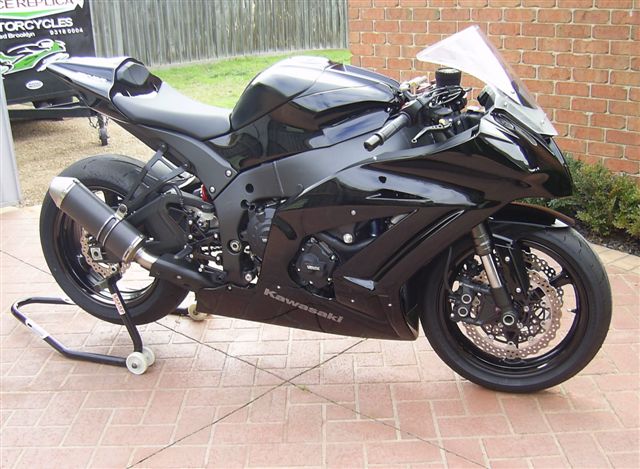

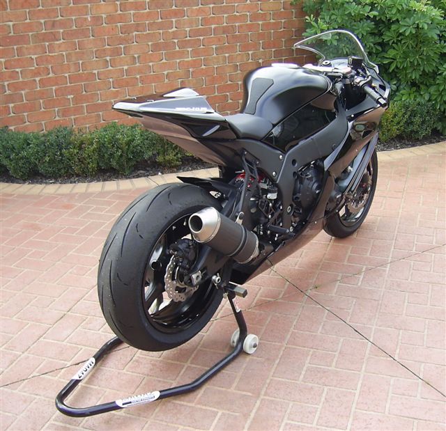

OK, the build up continues, (you must be getting sick of this by now :lol: )
Finally over the weekend I was been able to get the correct custom link pipe made, with many thanks to Mark from 'Madaz Performance' for an excellent custom job. So I was able to get everything fitted up this morning. Everything fitted up so well and relaxed, no forcing anywhere, and it sits nice and close without being too close to the swingarm. Definitely in closer than the stock muffler (even though I do like that look) but it sounds way better .. no metallic ring anymore, but a deep throaty carbon note. :D
So to sum everything up, I am now running the full Leo Vince EVO II system. Headers come to a 55mm mid point into the link pipe. The link pipe, which has the small resonator in the line, but is still 52mm straight through and has the lambda sensor fitted, this reduces further to 50.8mm and then goes into the carbon muffler... So an excellent performance system that is not ridiculously loud... It also allows for the stock heat shield to be fitted... ;)
New pics here, you can see the rear seat pad and new rearsets better as well. Braided lines have arrived at the post office.. So I will get them fitted tomorrow.
Macca :kuda:

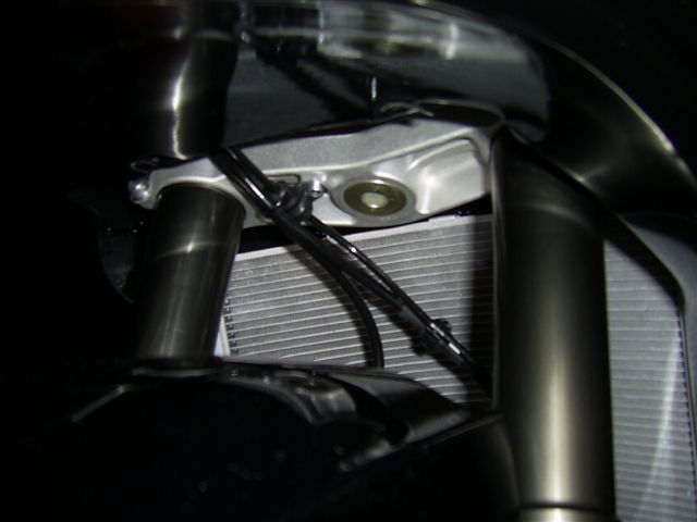

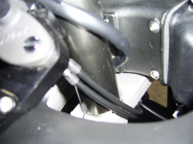

Anyway, the 'Speigler' braided lines arrived this morning, so they are already fitted. Very impressed with the whole set up, as they give you a rubber mounted clamp for the traction control wire to be mounted when you remove all the stock bulky lines, the lines also have rubber sections so you can use the stock clips for clipping the traction control wire back on as per stock, and larger rubbers also fitted so you can pop them back into the stock line holders.. This all makes for a perfectly fitting 'factory' look.. I am very impressed as I didn't know they where coming with all these extra's.
Also for those that dont already know, the 'Speigler' lines have adjustable banjo fittings, so you can swivel them around to get them just in the right position for fitting without twisting the lines around, or having the lines sitting there under tension.. So the whole set up went on in a relaxed position. Here are some installed pics.. they are not the best but you will get the general idea. Still waiting on one part for the 'Woodcraft' rearsets to finish this build up as they sent me the wrong part for the gear linkage :roll: .. Oh and the ohlins TTX of course, but that is coming up later on ;)
Macca... :kuda:

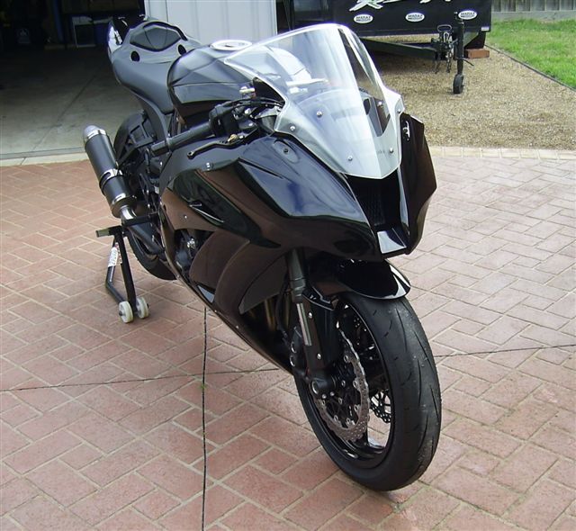

Postby Maccarocks » Fri Jul 15, 2011 9:29 pm
Ok, almost there...

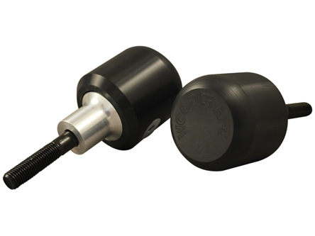

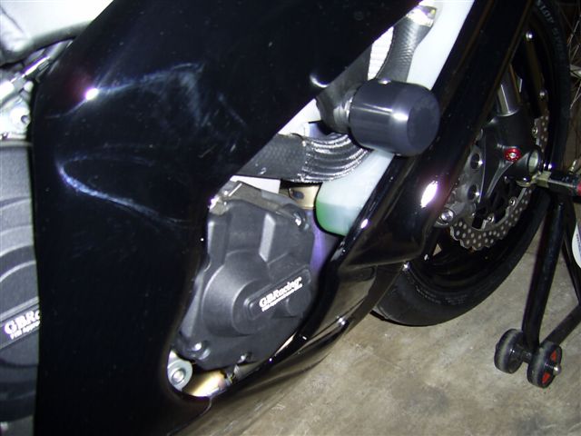

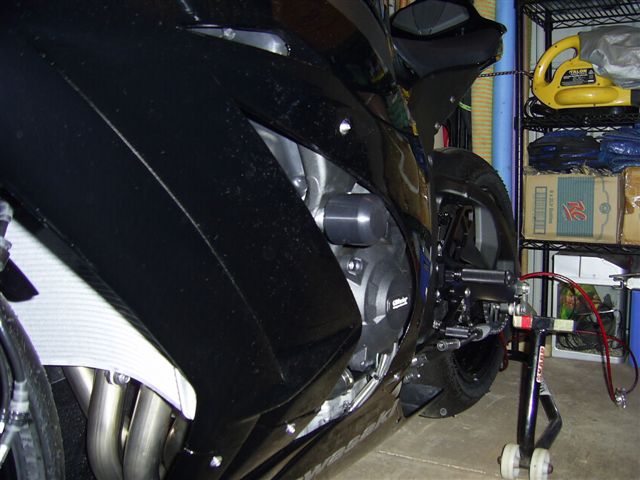

I decided to also fit a set of 'Woodcraft' frame sliders, as the frame is pretty wide on the shoulders right on the engine mounts, so these would definitely cop a beating in a crash. A lot of the other brands of frame sliders stick out way too much, but the 'Woodcraft' ones for this model sit in nice and close and are very well engineered to be very strong, and the pucks are replaceable, they just bolt off... :D
So here they are fitted. Seriously it was a 5 minute job.. probably 10 minutes for me because it was so frigging cold in the shed.. but a very easy fit. They are all threadlocked and ready to go. So to date the bike is basically now ready to ride. I will be swapping the rear shock over to an Ohlins TTX as soon as the budget allows, probably sooner ;)
I am very happy with the build up. I am not searching for anymore power, and since Kawaskai has enlarged the standard air filter by 48% for this model :shock: even the stock filter allows ample air in to breath, and with the Leo Vince EVO II Pipe fitted, it has way enough power for me. Handling is the way to go now 8)
