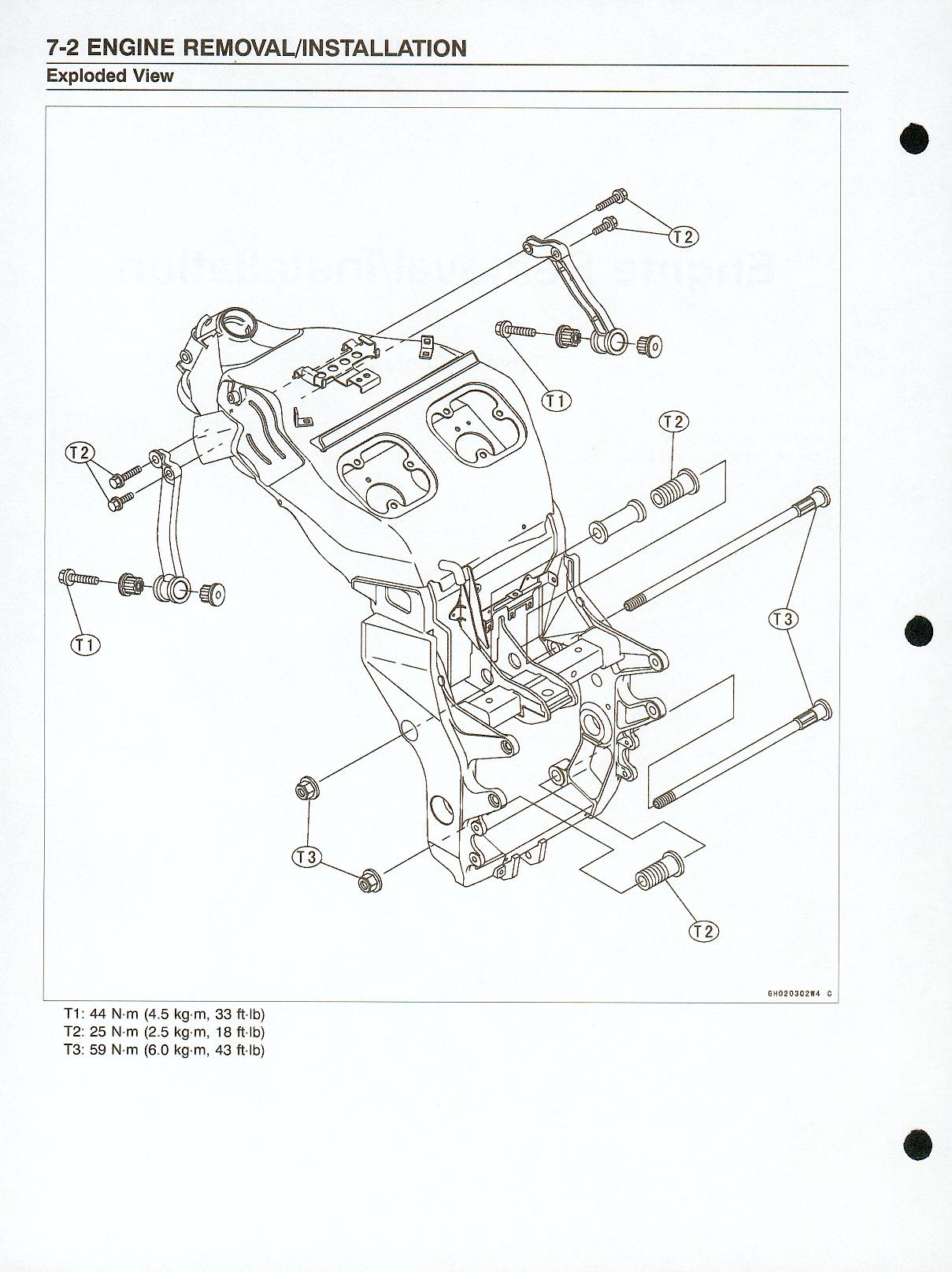

Postby hoffy » Wed Oct 25, 2006 5:37 pm
Better yet, here is chapter 7, engine removal and installation.

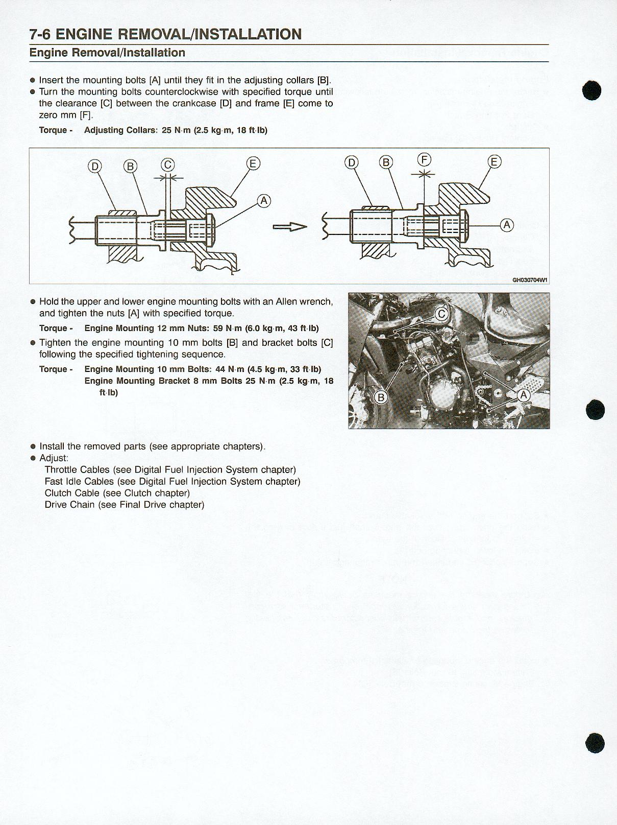

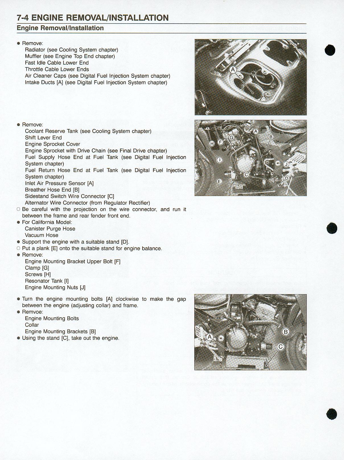

Postby hoffy » Wed Oct 25, 2006 5:39 pm
pages 3 4 & 5

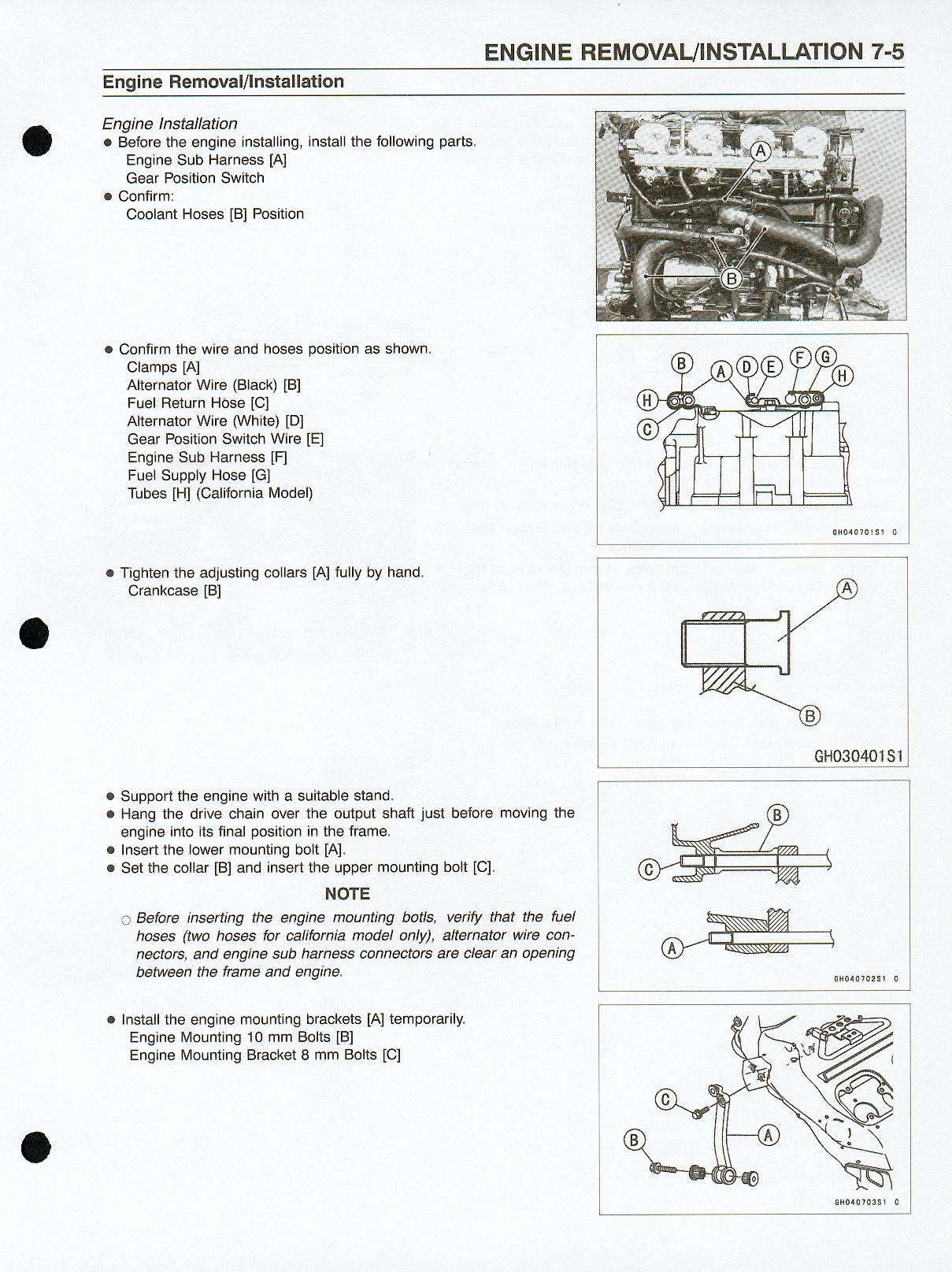

Postby hoffy » Wed Oct 25, 2006 5:41 pm
and last page 6, simply click to download..
