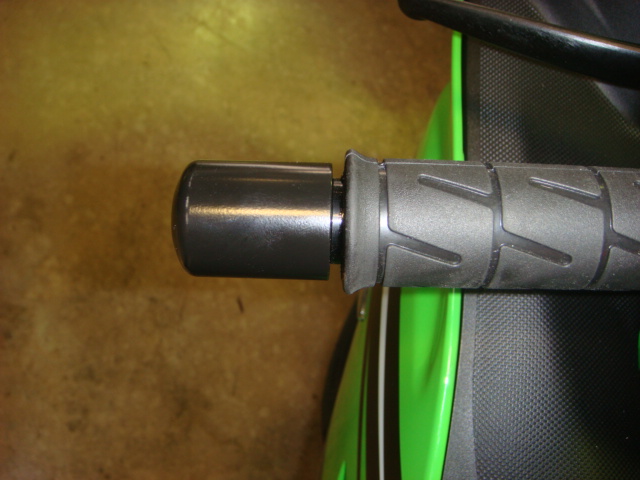

the problem is that where the bar end screws in to the handle bar, there's a gap between the bar end and the rubber handle and i can't seem to be able to close the gap...is it the bar end or rubber?

no, i mean it's only the left hand one......the right one is correct with minimum gapping...but the left hand bar end has about 1-2cm gap between the bar end and the rubber

If you have access to compressed air put the air gun nozzle under the edge and as it separates from the bar you can move it easily. Sounds more like the internals of the bar have moved or been pulled outwards. Try smacking the bar end weight with a hammer but put a block of wood there first so you don't damage it and see if it moves. Photo? Be easier to diagnose with a pic.
thanks will do tonite.......it's been dropped on the left hand side....so i hope it's not the internal bar.....

Postby hidepenny » Fri Feb 29, 2008 8:30 am
here's the pic

Postby Flywheels MC » Fri Feb 29, 2008 9:14 am
What does the gap at the other end look like? Pics!

Postby Flywheels MC » Fri Feb 29, 2008 9:22 am
Here are a couple of photos from a brand new 2008 ZX6R. The gap looks the same as yours so I wouldn't be overly concerned about it. Try stretching the grip towards the end or just colour that gold bit black so it's not so obvious

Postby hidepenny » Mon Mar 03, 2008 10:04 am
thx much for the effort and explaination....i had to pull and twist it really hard to move it down.....now there's a gap between the grip and where the light button part is......so it looks like the right hand side.....
