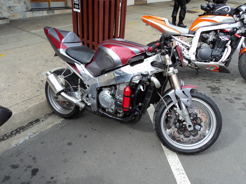

G'day mate, I'm unsure about the ZXR7 but when I put raisers and flat bars on my ZX9R I had to make sure the height and angle were sufficient so the bars did not hit the fork stems. I just drilled the top yoke and it was fine. On most bikes you have to get longer brake and clutch lines and also get you speedo cable extended. I've now gone back to clip ons but I'll post up a pic of my nine which should answer a lot of your questions.

The headlight I have used is just an enduro motor cross headlight and the overflow bottle is a sports water bottle, I replaced the OEM gauges with an Acewell gauge. In my previous post I said speedo cable, what I meant was throttle cable.
Hope that helps you with some of your questions mate.

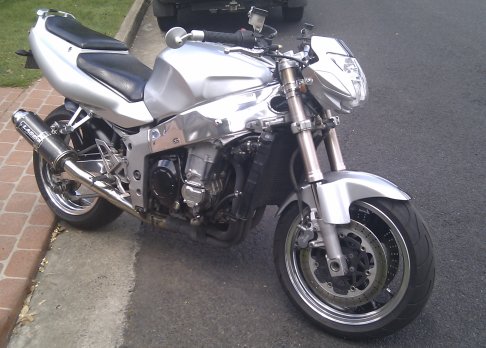

I ended up doing the same thing. Got the bars and risers at AUSfr and the Acewell at Extreme Creations. (Excuse the crappy pics taken on the phone) It's still a work in progress, but you get the idea. :D
