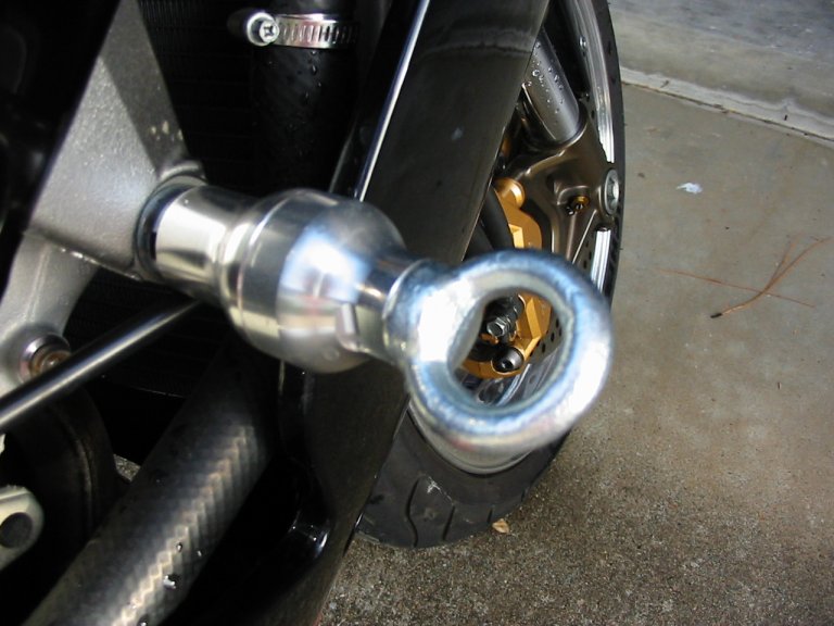

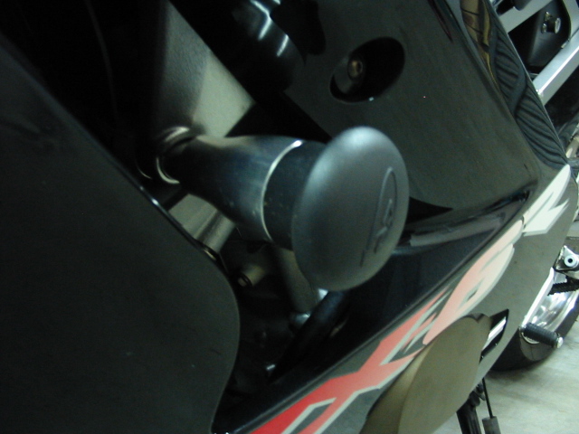

and i may be selling my bike.. would you be interested in my crash's? they're ER racing ones and the knob unscrews and hooks screw on to use as tie down points, it's what we used coming back from Melb and bike didn't move a cm :)

The stator cover is more practical than bling... it would protect the clutch bits more than the standard ones if you came down on that side :) The standard ones seem to be pretty soft, and they only want as much as a normal one is worth.. I immediately thought of you :D
Not sure about the frame sliders yet.. i'll wait to see how much i like the zed before i decide to sell this bike.. but if you are interested i can point you in the direction of the place i got them from..
