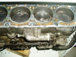

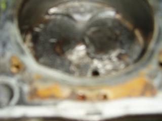

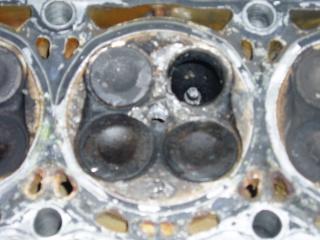

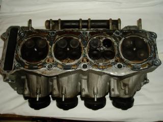

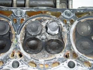

Jpbikeboy and i picked up James Laugesen's old ZXR750 L model engine for engine spares for our track bike project, seeing that jp's 750 motor's gearbox had taken a beating from the turbo, and that he was putting in the 900 for some turbo treatment.
After taking the head off our thoughts of a droped valve were true.
Check out the carnage.
Cheers,
Matt.
Damaged Cyl Head Closeup.jpg (30.13 KiB) Viewed 2770 times
Damaged Cyl Head With Valve.jpg (35.46 KiB) Viewed 2771 times
Piston hole.jpg (23.43 KiB) Viewed 2764 times
Piston hole1.jpg (33.04 KiB) Viewed 2765 times

Postby Smitty » Mon Feb 13, 2006 1:57 pm
hmmm
just caught this thread
from experience ....
'dropping' a valve rarely occurs because of high revolutions...
its just that it happens at high engine revolutions
and
is usually caused by -
poor lubrication of the valve stem/guide which results in galling of the stem (the stem will jam in the guide or break)
or
metallurgical failure of the valve due to poor filling of the valve stem (especially zorst valves)
or
a material stress failure due to incorrect valve clearances or incorrect manufacture of the valve.
What is also attributed as 'dropping a valve' occurs when the
collet fails and releases the valve.....
it is my experience that an Ottocycle (4stroke) engine which has proper lubrication and clearances of the overhead valve will normally break something else...
a pushrod or rocker arm or pivot ...maybe a even a valve spring before 'dropping a valve'
hth
