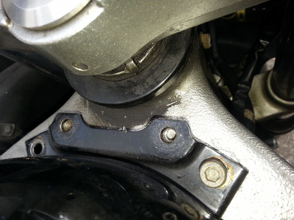

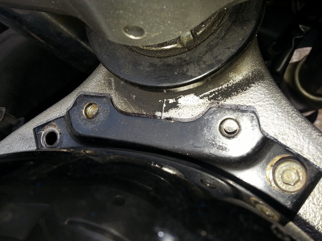

Postby RustyAs » Tue Apr 15, 2014 2:21 pm
Here are the pics. Not sure how long it took to get to this point
I havn't yet checked by trying to move the forks as Gos suggested. Will do that this weekend
bit of a wipe with finger
