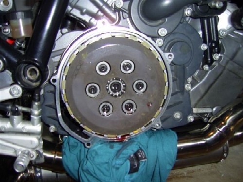

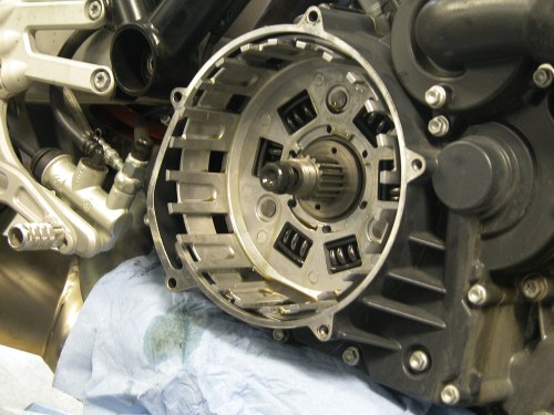

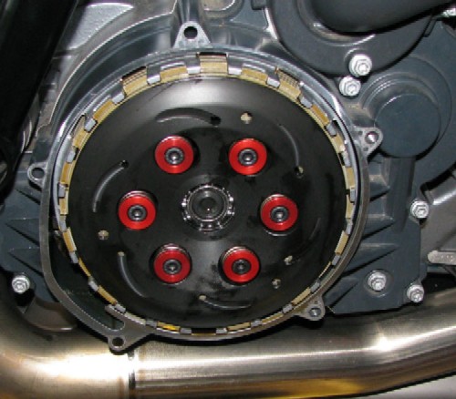

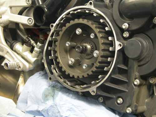

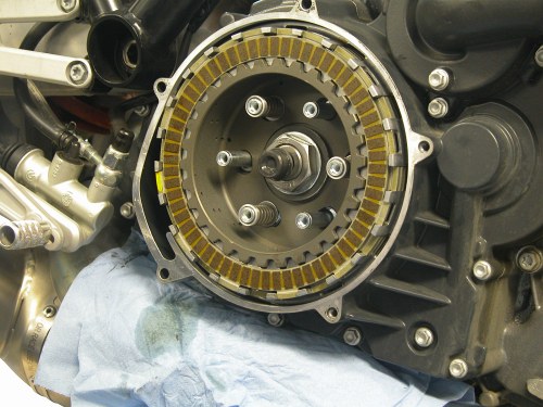

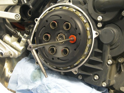

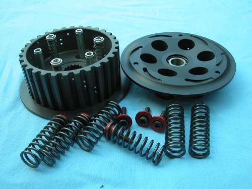

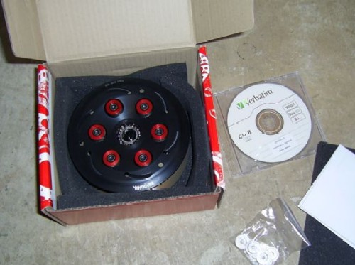

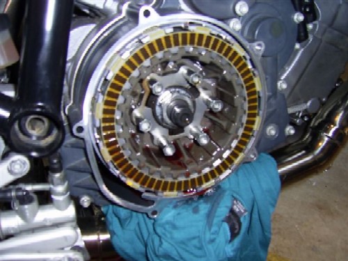

So I have now fitted the 'Yoyodyne' slipper clutch and have also learnt a lot about clutches along the way. It was a very simple job really. The clutch comes complete, pre-assembled and set up so the ball bearings in the ramp section do not fall out. They are all seated and the 3 small springs already fitted take care of that problem so it is a simple task to fit.

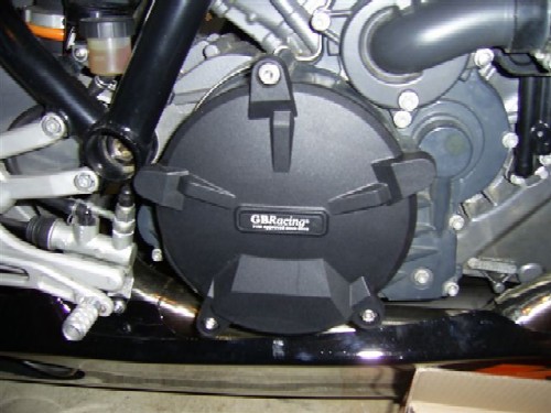

It is just a matter of draining the oil, removing the clutch cover, removing the pressure plate, removing all the clutch plates and steels (slight change in order when you put them back), then removing the stock clutch basket, replace with the new slipper clutch basket, torque the main centre nut up to 120 Nm, then replace the clutch pack (friction plates and steels) fit the new pressure plate, fit the new clutch springs and buckles (all supplied in the kit) and torque these up to 10Nm. Replace the cover, re-fill oil, start the bike and check for any leaks. :D The KTM cover has an 'O' ring as the gasket which looked fine, so I did not replace it, but it is not leaking anyway.
So I took the bike for a quick ride, clutch feeling is the same feeling as it was before as far as taking off (which it should be) but I was unable to test the 'slipper' part of the clutch as I could not get up to a high speed, but still I know the clutch is working as it should be. First track test is at Phillip Island on the 20th of August. This kit is set up with the correct springs and so is designed to work on the track, so I have no concerns about it not working correctly, it is a professional racing part. But I will do a track report after the test day anyway... Here are the pics in order, I hope it helps anyone doing a similar performance mod.
