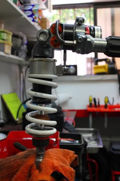

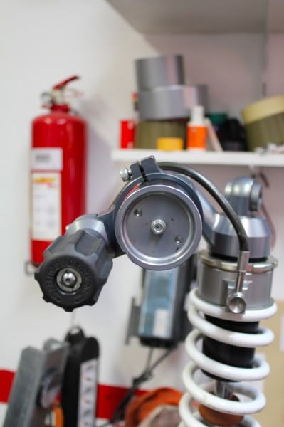

i am building an zx7r (1997 p2) for trackdays but i have some questions about suspension set..
my bike is full stock on suspension but now for the rear end i have this:
WP 4618 rear shock for ninja zx10 (2006/2007) with 90-150 spring (maybe is crap for this bike cause i just have 70kg and the bike maybe is 190kg wet as i saved some weight)
but as you all know this shock as less 12mm than stock!!!
i think im gonna compensate this with a 12mm spacer here:
what do you think?

well i know that the good is get ohlins zx7r specific shock...but i have this WP at home and i wanna use her..
i don´t know what settings to do and rise the rear..
