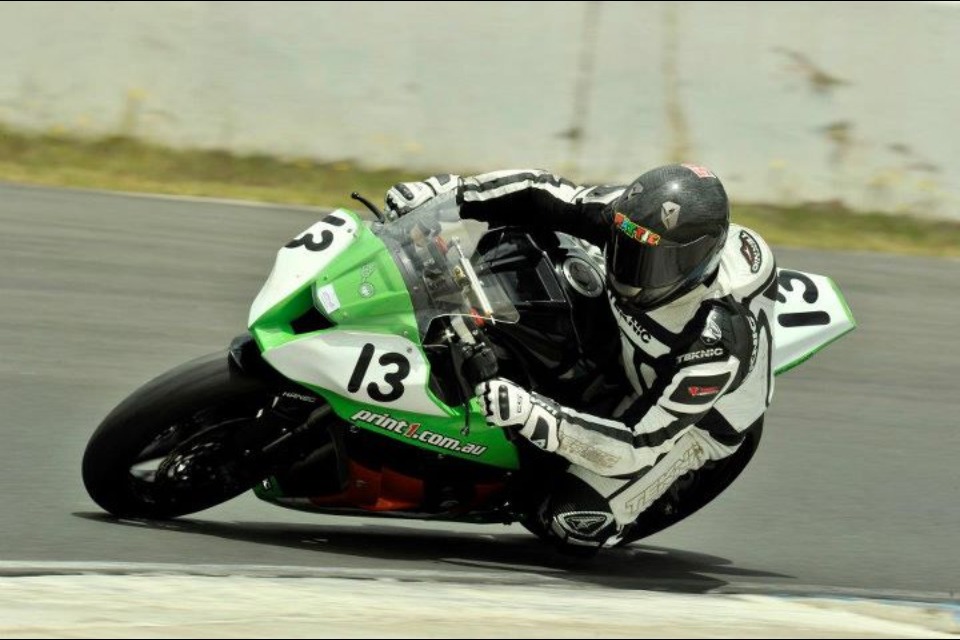

They said the OEM shock on the 2011 ZX10 wouldnt cut it on the track, absolutely correct. Shocking really :roll:
Didnt realise how bad until i seen this pic of it squatting, sags were set and comp was dialled all the way and back a wisker.
Looking through the other JPM photo's in this group no other bike was displaying this.
EC T9.jpg (115.56 KiB) Viewed 2091 times

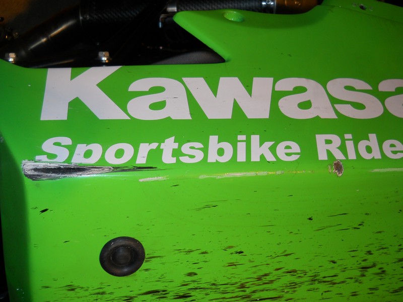

Could feel it scrape a few times, brings back memory's of the 12R's doing the same.
little scratch.jpg (148.49 KiB) Viewed 2091 times

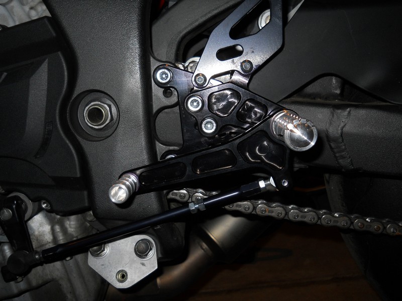

It was being a bit wheelie happy even with TC mode on and my boots were constantly being smashed into the tarmac which effectively had me re-adjusting my line.
rearsets 2.jpg (165.5 KiB) Viewed 2091 times
Next: install plastic tube to replace master cylinder.
rearsets 6.jpg (187.21 KiB) Viewed 2091 times

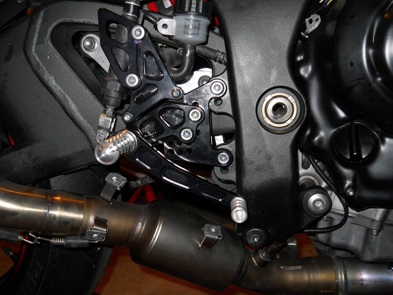

I will remove the ABS fuse as the brakes were quite wooden and a little bit unpredictable in ways when that kicked in, Bendix competition pads go in for a try out.. Was told it is just the fuse, then i have heard conflicting advice so anyhoo give it a whirl and see.
Replaced that brain buzzing Akrapovic shorty with a Leo Vince link and SBK muffler thanks to Maccarocks. Deeper and a bit quieter. :D
rearsets 1.jpg (193.06 KiB) Viewed 2091 times

Postby Wattie » Sat Dec 24, 2011 10:40 am
wheres that other pic Jonno?
its hows how much the geometry of the bike changes. theres one form the other side at turn 2. the belly pan is paralel with the ground as you are coasting (or little gas) then the one you put up you are rolling on the gas, it shows how bad the squat is.
Posts: 10041

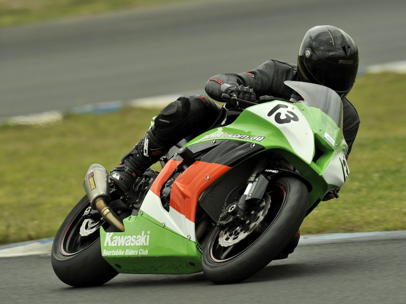

Wattie wrote:wheres that other pic Jonno?
Eastern Creek T2
2 exit.jpg (106.66 KiB) Viewed 1997 times

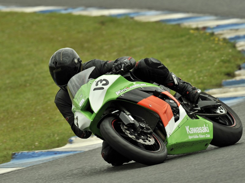

Postby Blurr » Sat Dec 24, 2011 11:18 am
Wattie wrote:I quite like this pic of Jonno's bike...
Jonno's bike is a slut :lol: :lol:

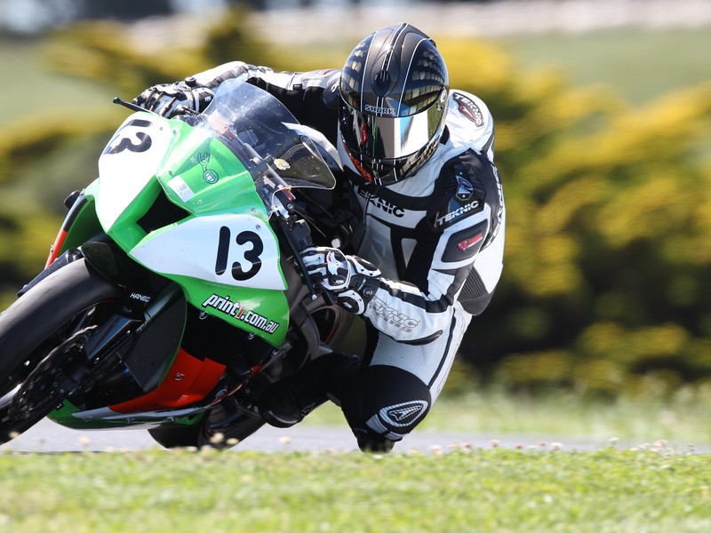

another good pic
PI 2011 3.jpg (144.51 KiB) Viewed 1985 times
