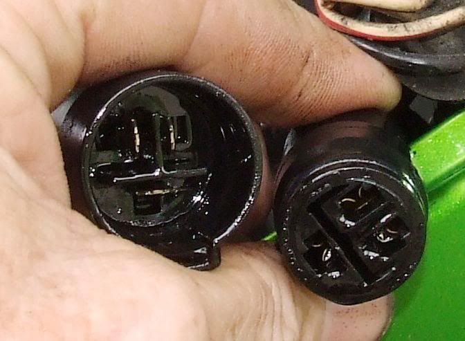

Postby mick12 » Mon Apr 25, 2011 10:49 pm
this could be an old subject my 12r recently stopped and would not wind over I blamed the battery I tried jumping it from 3 different batteries with no luck.Today i found oil in the regulator coupling which apparently happens at about 25 -30k kms [must of missed recall ] does any one know if this can damage the regulator and or ECU because of over charge maybe :evil: :evil: :x any help appreciated because next weekend is another long one and the rain has now stopped . I really need to ride

Gosling1 wrote:never heard of this fault before mate, my 12R has >50k on board now, and no problem like this ? It is on its 2nd battery now though - they generally fail between 4-5 years. What year is your 12 ? No recalls on the 05 model afaik ?
My ride Is an 01, the problem exists so i beleive from positive crancase pressure forcing oil up through the insulation to the barrel conector, just before the regulator, causing over heating of the wiring. I have been researching for a couple of days and found many others who have had the same problem.I have never heard of this before myself,but it does exist. Maybe your model was fixed before release but its still worth looking at.Some people have mentioned smoke coming from under the seat, others discoloured insulation but all had oil in the connector. Below is an adress to a forum page you will find four sticky topics related to this. If i can figure out how to upload photos i will do so.

Postby mick12 » Tue Apr 26, 2011 12:43 pm
Image I am finding it difficult to supply pics this is the best one so it will have to do for now i think i can show more but the way i am doing it means more seperate posts

Postby Jonno » Tue Apr 26, 2011 8:28 pm
Common issue on early models, oil wicking up the wires, there was a recall on this back way back then.

Postby Jonno » Wed Apr 27, 2011 4:31 pm
The replacement loom/part has been updated.
