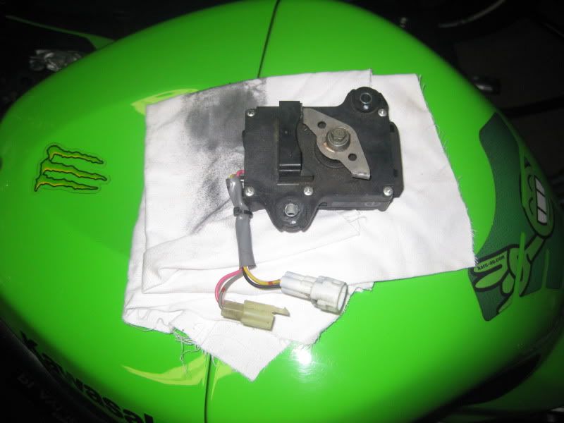

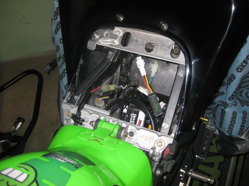

My servo motor died over a year ago... FI light has been on since.
With rumours the bike can go into limp mode i'd thought i' get it sorted, So finally i swapped this
For this

Postby Wattie » Thu Oct 14, 2010 9:14 pm
what is it??

Postby zxsixr03 » Thu Oct 14, 2010 9:23 pm
Servo eliminator circuit board....tricks the ecu acting like the oem motor. Weighs approx 1 gram compared to a few kg's for the servo motor.
With the carbon speed battery its a free 10kg weight loss

Postby Blurr » Thu Oct 14, 2010 9:24 pm
Does it just close the servo circuit loop?
Re: Servo fix
Postby zxsixr03 » Thu Oct 14, 2010 9:25 pm
In a nut shell yes...lol
