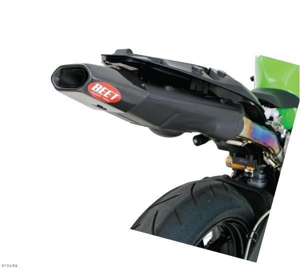

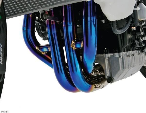

As mentioned above go the slip -on but get it custom mapped the '07 models have a lot to gain with a new map and air filter, re gear the bike to give u more torque +3 teeth on the rear sprocket would be a start.
Or if u have a gold mine get one of these...
