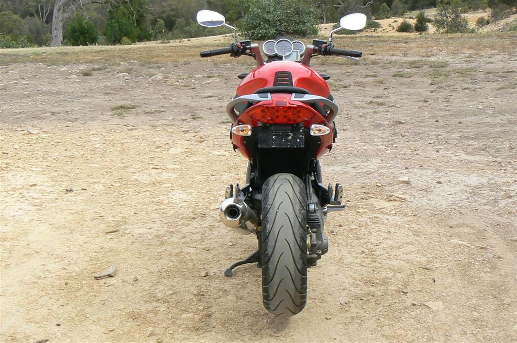

Postby simpleton » Wed Apr 28, 2010 11:31 am
Thanks for the input guys.
I will look around for something maybe 16 Amp/h and see what the cost is, otherwise settle for the 14.The 18 or 20 Amp\h was $299 !!!!!! and I know the 14 are under $100. "Monkey Porn" man has given a wbesite link, thanks Red Dave. Still don not know what Monkey Porn is, he will not tell me.
It is not for a GTR, it is one of the "dark side" bikes.
