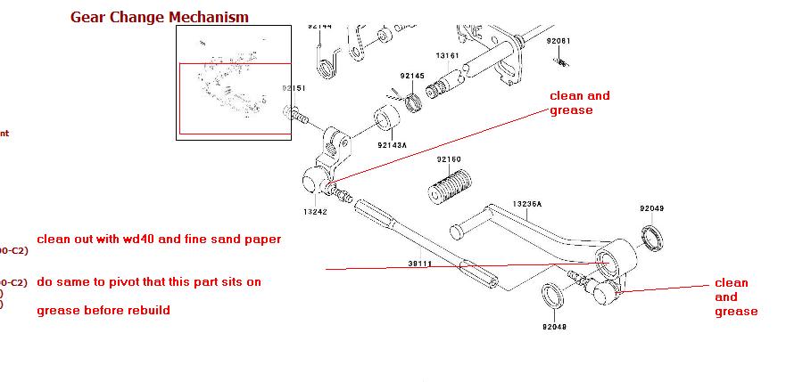

IF you didn't kick it up far enough....... operator error ;) , knocking it back down without the clutch will cause a clunk too :D
However, the 9's do love a little care and attention to the pivot points on the gear lever - if you haven't done it yet, then it's worth stripping the linkage, cleaning and greasing the pivot points
gear linkage.jpg (41.63 KiB) Viewed 1272 times

yeah, i may have not put enough effort into the gear change... :oops: ah well, live and learn.
As far as giving the lever a clean, should i pull it all apart, or can i get away with just removing the lever and a few bolts... im a hands on guy but i havent done it before and im pretty paranoid about putting everything back together the right way... the less i take off the less there is for me to scew up! =P
(thanks for the diagram too! handy)

those ball joint type things with the clean and grease red lines. Also check that where the are fitted to the levers that they are not loose, just had my six apart and they had worked loose so just peened the rivits over and it shifts better now, a lot less sloppy.

craig wrote:Rossi you should publish a revised manual ........."for mechanically void riders" that denoted graphic is what most need to try minor tasks if not sure of their ability :) 8) ........gotta be market there
I'd love to take the credit for it, but I got it from somewhere else (buggered if I can remember though) & knew it would come in handy to explain to someone else
