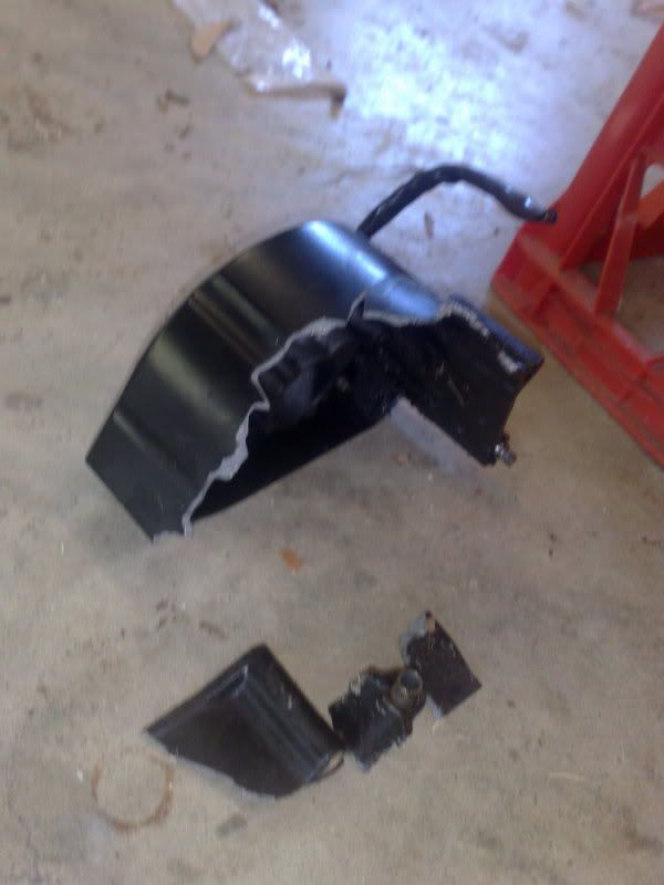

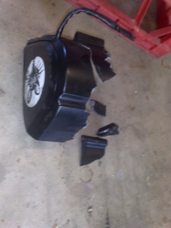

Well guys, last week i had the chain coem off and thought all was good and it only destroyed the rear hugger, so today i thought id clean out the front sprocket and put the chain back on, well, when i went to remove the sprocket cover i found it was all a little worse then expected :(

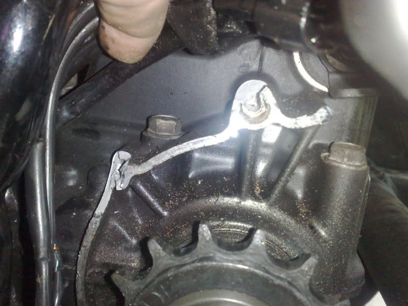

As you can see not only is the cover cracked but its severed the wires and cracked the castings where the cover bolts into.... Im not all that mechanical minded but this doesnt look good and looks miiigghhttyyyy expensive
Any tips?

ouch, looks like a nasty repair at the least. Maybe if your lucky JB weld could fix it, but i'll not say that'd be the final fix. Aluminium can usually be welded, though i doubt that the case could be welded while on the bike. Is this a side cover that can be unbolted from the engine? or is it an integral part of the case? if its like any part i've dealt with it'll be a removeable side plate.
If welding doesn't fix it then im guessing it'll be replacement time. Though i'd suggest getting ideas from people who know what they are talking about rather than me.
Re: Chain came loose, Casued too much damage :(
Postby robracer » Sun Nov 22, 2009 6:03 pm
Clean it up with degreaser & run the bike to see if you have any leaks, if there are no leaks keep the cover off so you can keep an eye out for leaks in the future, as for the wires cut them & join them, any auto electrician can help if its too hard for you do do the wiring.
This is subject to having a mechanic check it out & give you the all clear as the problem could be worse than you can see.
Oh & i think the wiring will be the Neutral sensor so its no biggie in the short term.

robracer wrote:Clean it up with degreaser & run the bike to see if you have any leaks, if there are no leaks keep the cover off so you can keep an eye out for leaks in the future, as for the wires cut them & join them, any auto electrician can help if its too hard for you do do the wiring.
Rob
think thats a speedo sensor on the Z7fiddys ...not the neutral switch (might be wrong but)

im thinkin ill just chuck it in the back of the van and take it to a few places and see what they say...... get an idea of what we are really in for, could always make a bracket up for the speed sensor

I havent taken it round yet, but spoke to a mate today that knows how to weld, and he suggested smoothing the casting back and he will weld in a new bracket system to hold the sprocket cover onto, still a motor out job tho :(

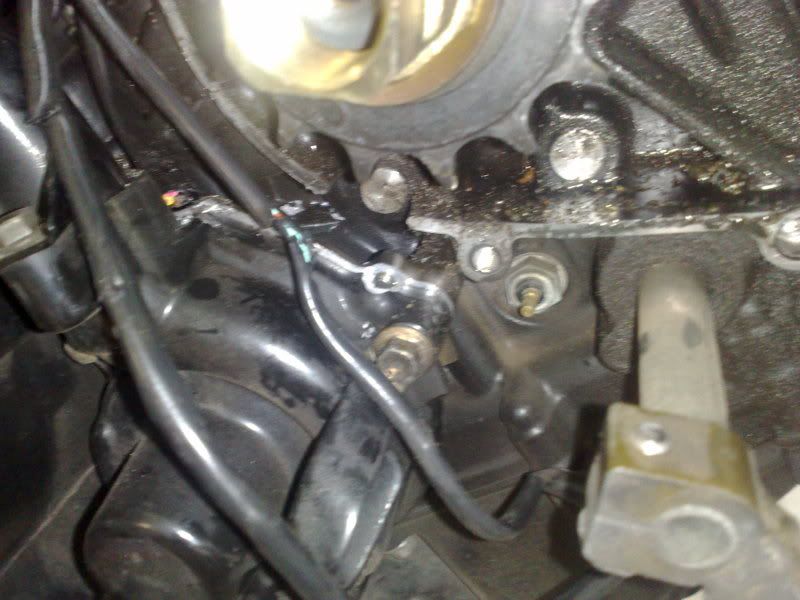

Also, in this pic does anyone know what the circular item down the bottom is (you can see something has taken a chunk out of the corner above the top bolt)
Is it a water pump or thermostat or something like that? i unded a few bolts and coolant came out so im guessing its something to do with the cooling system.
and in that pic, the sensor that isnt connected to anything (to the right of the bolt im talking about) whats it do? lol, should of known all this stuff a long time ago i guess, but im still fresh to bikes so im not pretending i know it all.

Postby robracer » Wed Nov 25, 2009 6:53 pm
Yep thats your water pump housing
& neutral sensor

Postby 67-FKD » Wed Nov 25, 2009 7:01 pm
thanks mate, cant start the bike and check for leaks due to the state of the electrics, ill have to do something dodgy and hook them all back up over the weekend. im concerned about the chip out of the top of the housing too.

Postby robracer » Wed Nov 25, 2009 7:14 pm
Could be filled with liquid metal putty but would have to be done properly.
Once again suss out you local mechanic for guidance ;)
