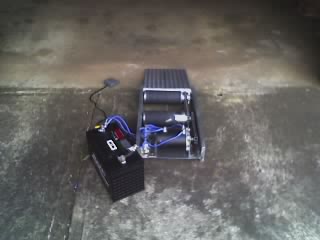

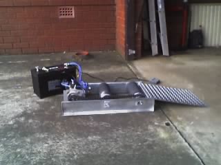

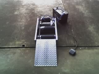

I have one for sale that I knocked up, using a winch motor.

I only built one, but can give you the info to build your own. :kuda:
